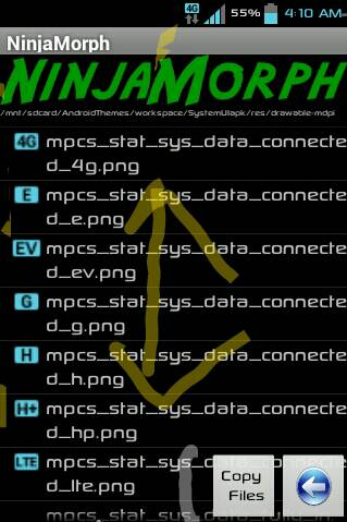

Change these 2. Its in drawable mdpi.
You have to choose copy in ninjas morph and copy the files from the system ui. Then you will be able to replace the 4g icon with the lte icon in the copied folder
Ninja morph is easy and you can do dinner cool stuff with it just don't mess with .9 pngs. Lol. Just play around with it. Make sure u make a copy of your original files. You may need it;)
PS. Post your changes made with ninjas morph
