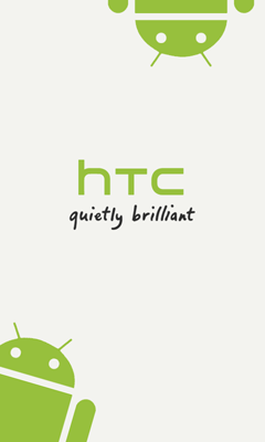

Just a quick thought, the first screen that appears is the splash screen and then the 2nd one is the bootscreen. The second one is normally the one with the green htc writing and quietly brilliant.
Is it the bootscreen you want to change or the splash?

Figured I'd share the love of my new splash screen with my fellow desire comrades. I've got the PB99IMG.zip file just not sure how to share it with out opening up a file hosting account (seems like a lot for just one file) anyone know of a site that you can upload android splash screens to then i can post the link here?
Edit: added PB99IMG.zip to XDA Here

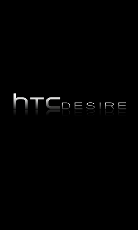

Here's a preview (suggestions or tweaks welcomed)
Added this one aswell, in the same above XDA thread.
