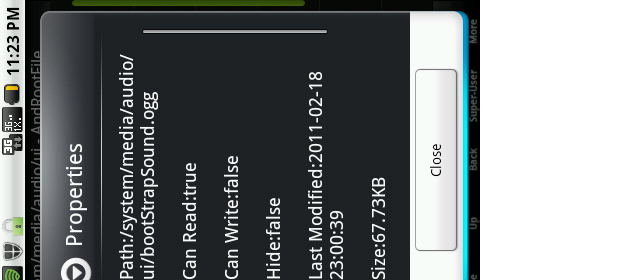

So this is what I got...

I'm still having trouble. I did exactly what was said above and I still don't hear my new startup/bootup sound nor do I see the new images.
I keep getting the message "Can't write to file: /system/media/audio/ui/bootstrapsound.ogg"
Any suggestions?

I appreciate the help but I've done that also. No methods have worked. I use ROOT EXPLORER and X-PLORE as well. Still open to any suggestions. I am new at this so feel free to go into great detail if you must. Thank you.
