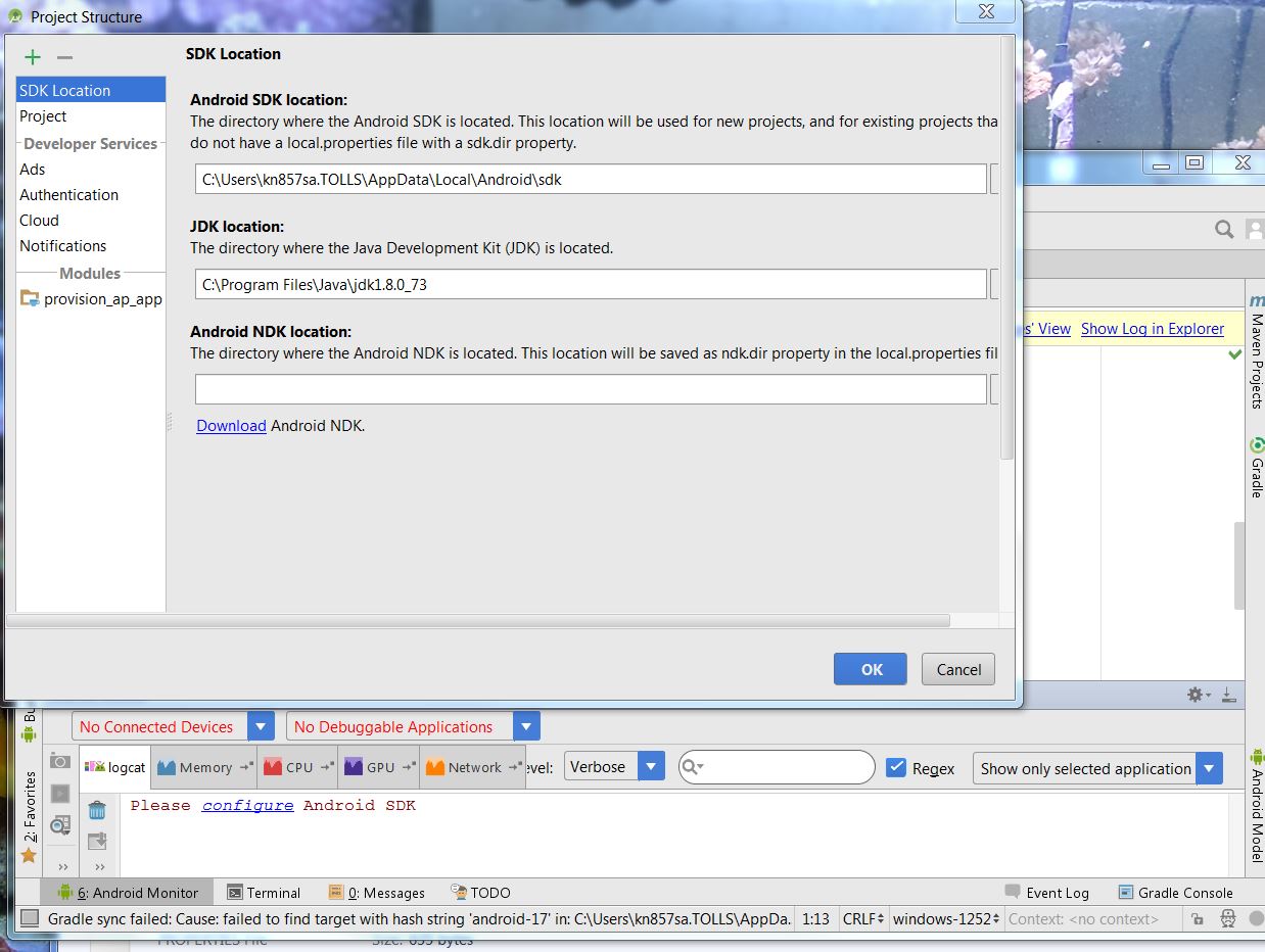

actually the complete error I am getting is
Error:A problem occurred configuring project ':app'.
> failed to find target with hash string 'android-17' in: C:\Users\user1\AppData\Local\Android\sdk1
<a href="openAndroidSdkManager">Open Android SDK Manager</a>"
I checked and the SDK path is set properly . please see the attached files

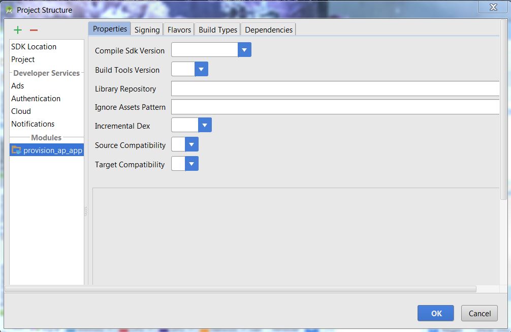

the SDK information is missing from project module though . .don't know if its normal or not. but I don't know what to f ill there as the drop down list show nothing .

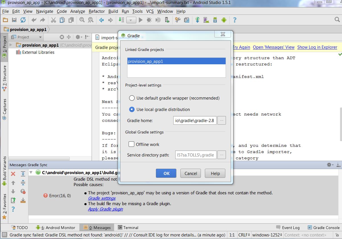

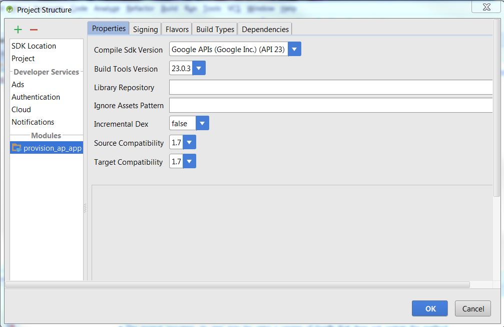

after downloading bunch of updates by android sdk manager I can now see options in the module settings which I set as shown in picture but I still get build errors as shown in the picture.

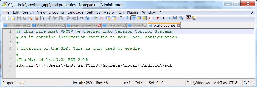

also I have a feeling this could be a problem in the project.properties file :
is this target version correct?
# Project target.
target=android-17

I have good news , the build succeeded. The problem was the wrong target in the project.properties file I set it to android-23 and it worked .
