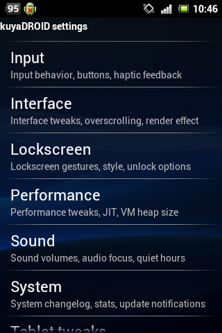

Thanks man, you helped a lot!!! I installed Froyo, but i didn't like it, has some bugs (camera and bluetooth doesn't work) so i installed GingerXperia (Picture bellow) i am happy now, works AMAZING and FAST and have that cool look. :) And now-back to my first quiestion: i saw there is CyanogenMod settings, AND i saw there options like CPU settings and Overclock and Undervolt. How to manage those things without screwing the phone? I read there that Undervolting is for extending battery, but can be that combined with Overclock (i think clocked processor might need more power, right?)

Depends on your phone. Mine for example can handle UV really well, but kills itself almost instantly when I was to try to OC.
Now you probably have a stock kernel. Whatever changes you do with it won't have any effect unless you're using modules. Modules are basically extensions of the kernel, and can offer you something the original kernel couldn't. They are possibly already included in the ROM, so you should check that out first.
When and if you have/don't have them, check these two links:
http://forum.xda-developers.com/showthread.php?t=1042929
http://forum.xda-developers.com/showthread.php?t=1020313
... and start experimenting. Don't worry if your phone reboots a few times before finding the optimum. And don't insmod the unstable settings until you're absolutely sure there are no reboots.
When you're ready to unlock your bootloader, check this:
http://forum.xda-developers.com/showthread.php?t=1549696
But be aware - unlocking the bootloader can kill your phone. Read the instructions VERY carefully.
