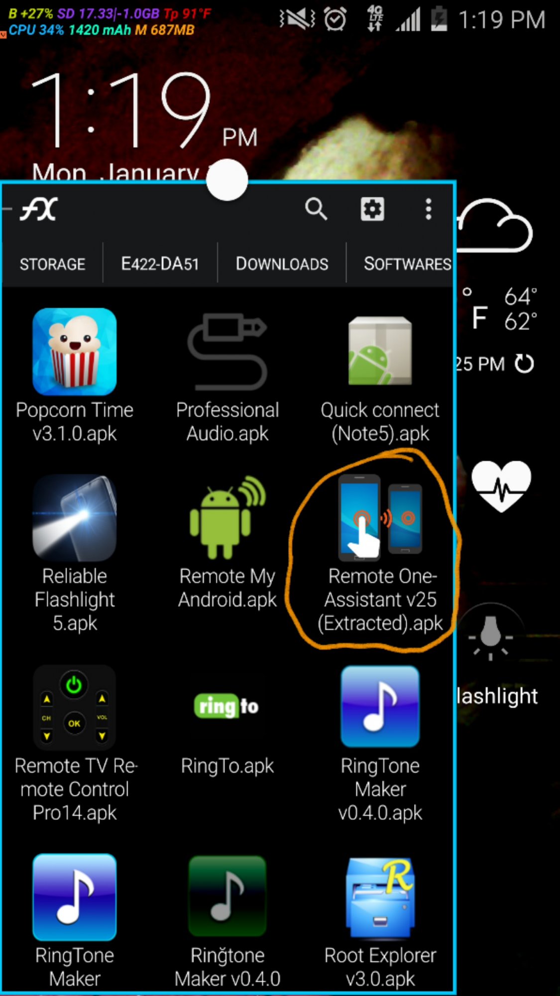

You mentioned you are looking for an app to do that..you could dl Alfred Camera in both phones..Alfred is mostly video based..but also takes photos..
If that's not the kind of app you are looking for you can try the one I've included in the picture for you(exhibits1)..

One phone as camera and another one as viewer not for casting screen from one phone to another phone. Anyway I'll subscribe their forum later to see whether there are other suggestions.
Remote One-Assistant v25 is NOT on "Google Play" of my Samsung S9+ mobile phone. Instead "Screen Share-OneAssistant" is there. I suppose it also need Internet or WiFi to work.

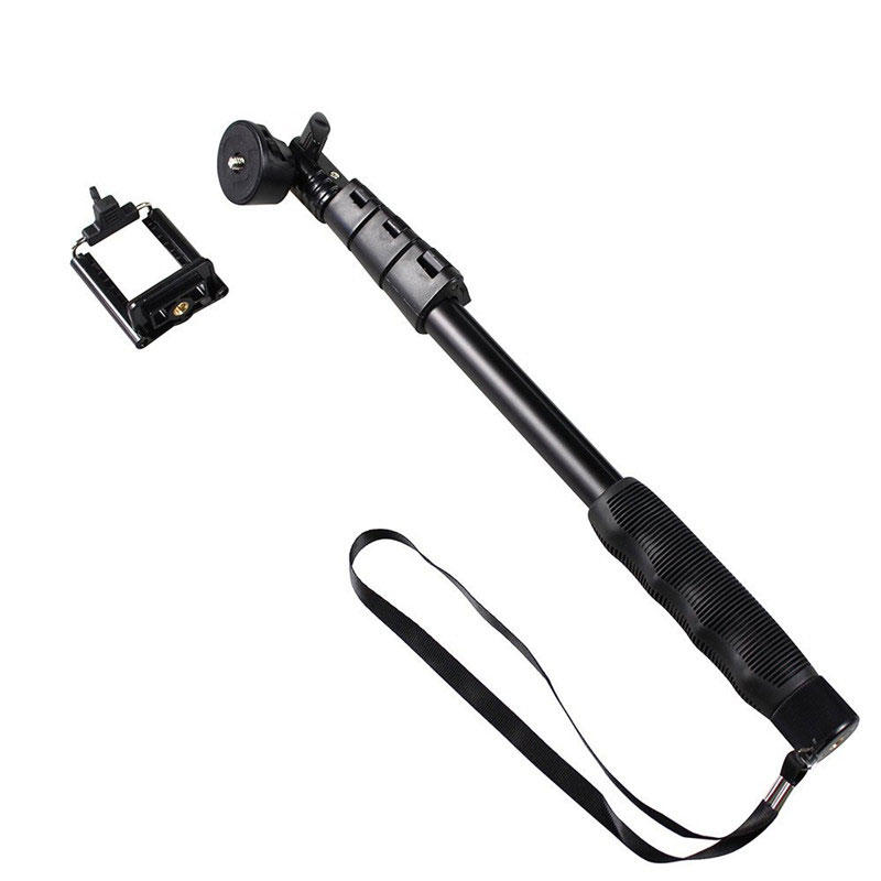

For ON/OFF taking photo/video my Yunteng monopod already has this function.
Pls see attached photo.
satimis
