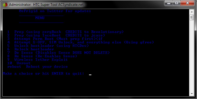

I take that back. It seems that WFS has problems with Z4root. Gingerbreak works for some (tks, El Presidente). ZergRush is known to work well with WFS, and TacoRoot works as well.
To make it easy, try the HTC SuperTool v3 by XDA dev frigid and don't forget to hit the thanks button on his thread! Be sure to get version 3, not version 2. (Direct download here.) Run the tool and choose the following options (see attached jpg below):
1) Press 1 (Prep using zergRush) followed by enter
2) Press 3 (Attempt perm root) followed by enter. It will tell you if the phone was successfully rooted.
3) Type "reboot" and press enter to reboot the phone.
If that doesn't fly, try this sequence of options:
1) Press 2 (Prep using TacoRoot) followed by enter
I was able to root my A510e (unlocked bootloader, S-ON) with option 1 (ZergRush) in HTC SuperTools 3.

how much time does it take for 'Loading Root Script' ?
Please relpy as soon as possible
It's been 2 hrs since your post, so I hope not that long. :D Seriously, don't worry. It's not bricked. It should only take a few seconds to a minute if I remember correctly.
Did you remember to enable USB debugging?
