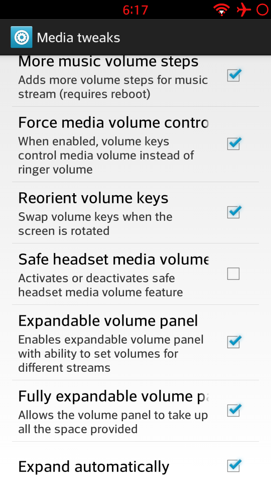

10.(optional) If you use gravitybox and you go into media options you can add 15 volume steps to your device and that makes both headphone and speaker volumes levels far higher than before.

No, forcing v4a will definitely cause battery drain because if the driver is already loaded and you choose to force it it's like doubling up on resources when it's really not needed to do so since converting this app to system is the key how it behaves :) I forgot to put this in the OP but if you use gravitybox and you go into media options you can add 15 volume steps to your device and that makes both headphone and speaker volumes levels far higher than before.

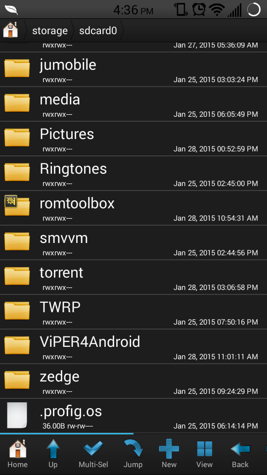

I can't find the profiles folder, or even the viper folder, to download and install the ones in the xda thread. I made viper a system app but I didn't find it when looking through /system
Check in your root internal sd folder, it was the last place I looked too. The profiles for viper fx are stored in there, just extract the viperfx profiles zip from the xda thread in there. There is a download for the flashable .zip on the page as well as a seperate .zip for the new profiles.
