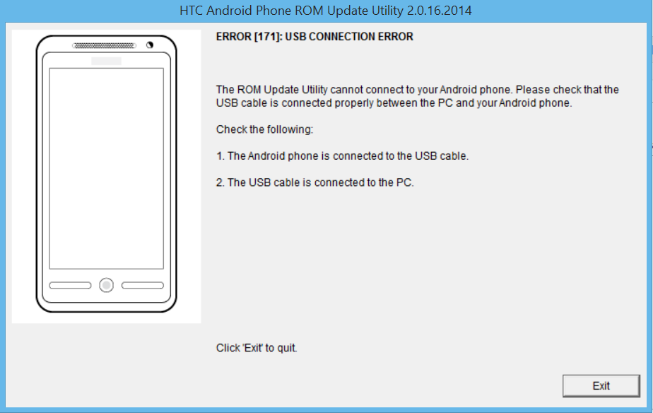

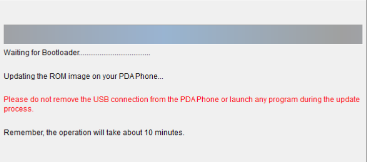

I started official HTC kitkat 4.4.4. RUU downloaded from http://forum.xda-developers.com/showthread.php?t=2751432 here because i downloaded it yesterday.
it says this:
and after trying to enter bootloader- again cca 1 minute wait- it enters bootloader fastboot usb mode and after 15 secs it says this:

The lack of a USB connection points to driver issues. Odd since you heard the phone connect noises. When plugged in do you see FASTBOOT USB on the bootloader screen?
It may be worthwhile downloading a couple of things. Will dig out some links.
