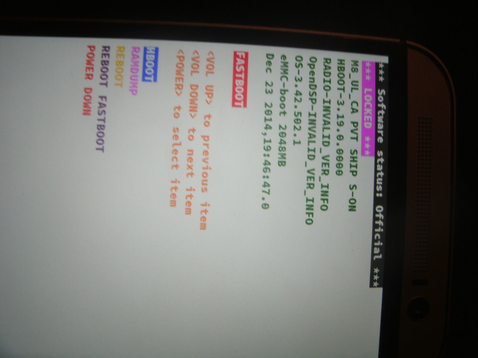

My phone failed an official update over the air. It won't boot past the bootloader. The phone is carrier unlocked (originally AT&T).
Recovery and Factory Default options do not work. They simply go back to bootloader. The most recent RUU does not work. It reboots my phone, and when my phone comes back the RUU says the cable was disconnected. I have no warranty. I am also concerned by the missing info, shown in the image.

One thought: I would guess this was an ATT update, as the phone's CID would still be ATT, so you could try asking them anyway. You may not have a warranty, but if their update broke the phone you could argue that they have a moral responsibility.
Otherwise, your other thread left off with a charge level problem - is that fixed now? And by now there may be newer RUUs (Lollipop) so it may be worth trying that. There is also a trick to extract a zip from the RUU .exe which can be installed from sd via the bootloader (not recovery) if you can't get the USB connection stable, but I'd need to do a bit of research to find the magic filename needed for the M8.

Plug your phone in to your pc so it says FASTBOOT USB.
Say this in the command window -
fastboot getvar all
And tell us what it says back - edit out your meid and serial numbers before posting.
You've selected the right RUU for a carrier branded AT&T phone - the steps above will confirm the internals and let us know if the bootloader got very scrambled on the failed update, all of which is in your interest to have us review prior to running the RUU.
What's does pretty much mean?
Is your CID still CWS__001?
Is your cable intermittent?
What happens from FASTBOOT USB mode and -
fastboot oem rebootRUU

C:\Users\Tyler\Downloads\fastboot-win>fastboot getvar all
(bootloader) version: 0.5
(bootloader) version-bootloader: 3.19.0.0000
(bootloader) version-baseband: INVALID_VER_INFO
(bootloader) version-cpld: None
(bootloader) version-microp: None
(bootloader) version-main: 3.42.502.1
(bootloader) version-misc: PVT SHIP S-ON
(bootloader) serialno: (VALID SERIAL NUMBER)
(bootloader) imei: (VALID IMEI)
(bootloader) imei2: Not Support
(bootloader) meid: 00000000000000
(bootloader) product: m8_ul_ca
(bootloader) platform: hTCBmsm8974
(bootloader) modelid: 0P6B12000
(bootloader) cidnum: CWS__001
(bootloader) battery-status: good
(bootloader) battery-voltage: 0mV
(bootloader) partition-layout: Generic
(bootloader) security: on
(bootloader) build-mode: SHIP
(bootloader) boot-mode: FASTBOOT
(bootloader) commitno-bootloader: 56f9ae32
(bootloader) hbootpreupdate: 11
(bootloader) gencheckpt: 0
all: Done!
finished. total time: 0.010s

Well, perhaps it is a paper weight. Failed at step 1.
Partition update fail!
Update Fail!
Device halted due to Large Image update fail!

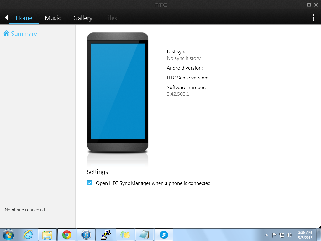

Perhaps the download was corrupted (that's a long shot). I can get the md5 of the rom.zip but I can't find the md5 on HTC's side, to compare.
Or were you saying that came next after the HTC Sync attempt?
I guess it didn't see my phone. It's just when HBOOT was loading the zip, Sync Manager opened (as it's supposed to when a phone is detected). After that, I started the update and then came the fail message.
Confirmed it. HTC Sync can see my phone when it's in Fastboot USB mode (which makes sense).
I'm surprised there's no way to revive even a phone in this status. Like a way to fix the bootloader.
