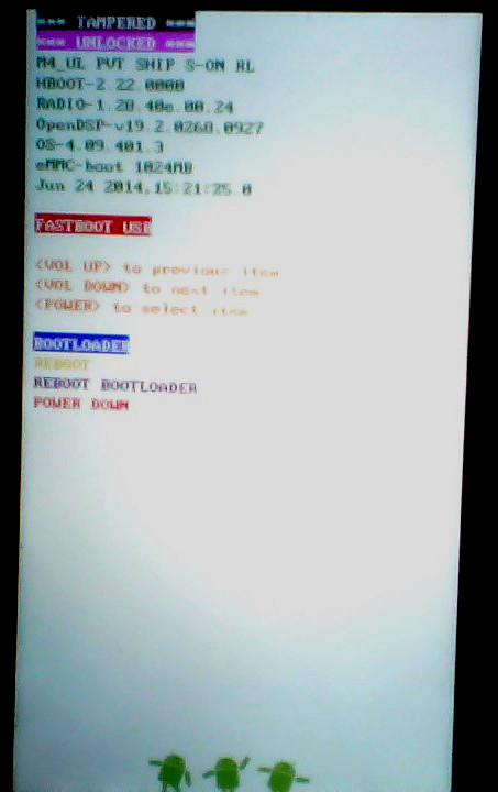

Thank you. Here's the bootloader screen, sorry about the bad quality, I've written out all the technical stuff here. Don't know if it's worth mentioning but I was running Kitkat 4.4.2 before this.
Also whenever I power off from TWRP it says "Your device does not appear to be rooted. Install SuperSU now? This will root your device." I install it and I get the same message next time I power off.
*** TAMPERED ***
*** UNLOCKED ***
M4_UL PVT SHIP S-ON RL
HBOOT-2.22.0000
RADIO-1.28. 40e.00.24
OpenDSP-v19.2.0268.0927
OS-4.09.401.3
eMMC-boot 1024MB
OK, it sounds like you have TWRP working. Don't worry about the failure to install superuser by TWRP - it's not what you really want here.
Make sure you use the latest TWRP -
https://dl.twrp.me/m4ul/twrp-2.8.7.0-m4.img.html
If you are using TWRP 2.7.0 or lower it's not going to work with your hboot version.
Download version 3 from here -
http://forum.xda-developers.com/htc...-official-stock-sense-6-rom-firmware-t2817921
From TWRP, MOUNT - check to mount the internal storage (internal sd card).
At that point, your pc ought to see your phone and let you copy the rom zip file over.
When complete, uncheck the storage you mounted - nothing else, leave everything else as it was.
TWRP, WIPE, ADVANCED - choose to wipe boot, system and data ONLY.
TWRP, INSTALL - select the rom zip your copied over, install it.
It's already a rooted rom - let me know what happens.

I have no mount option for the sdcard but I've pushed the file over with adb. In TWRP, WIPE, ADVANCED I only have: Dalvik cache, cache, Data, Internal Storage, System, USB OTG. Should I just wipe data and system? I thought dalvik cache was always a must before installing a new ROM?
