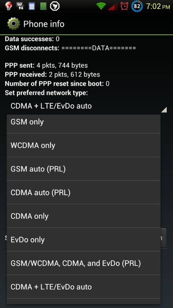

The following two shots are both for Network Settings, taken just now on my HTC.
The first is a service menu (that some versions access with the debug dialing thing).
It lists everything that every version of my phone does.
The second is also the Network Settings, and these are the ones that count and indicate your radios.
Unless you're on AT&T in the USA, which was why I wanted to be sure about your carrier.
