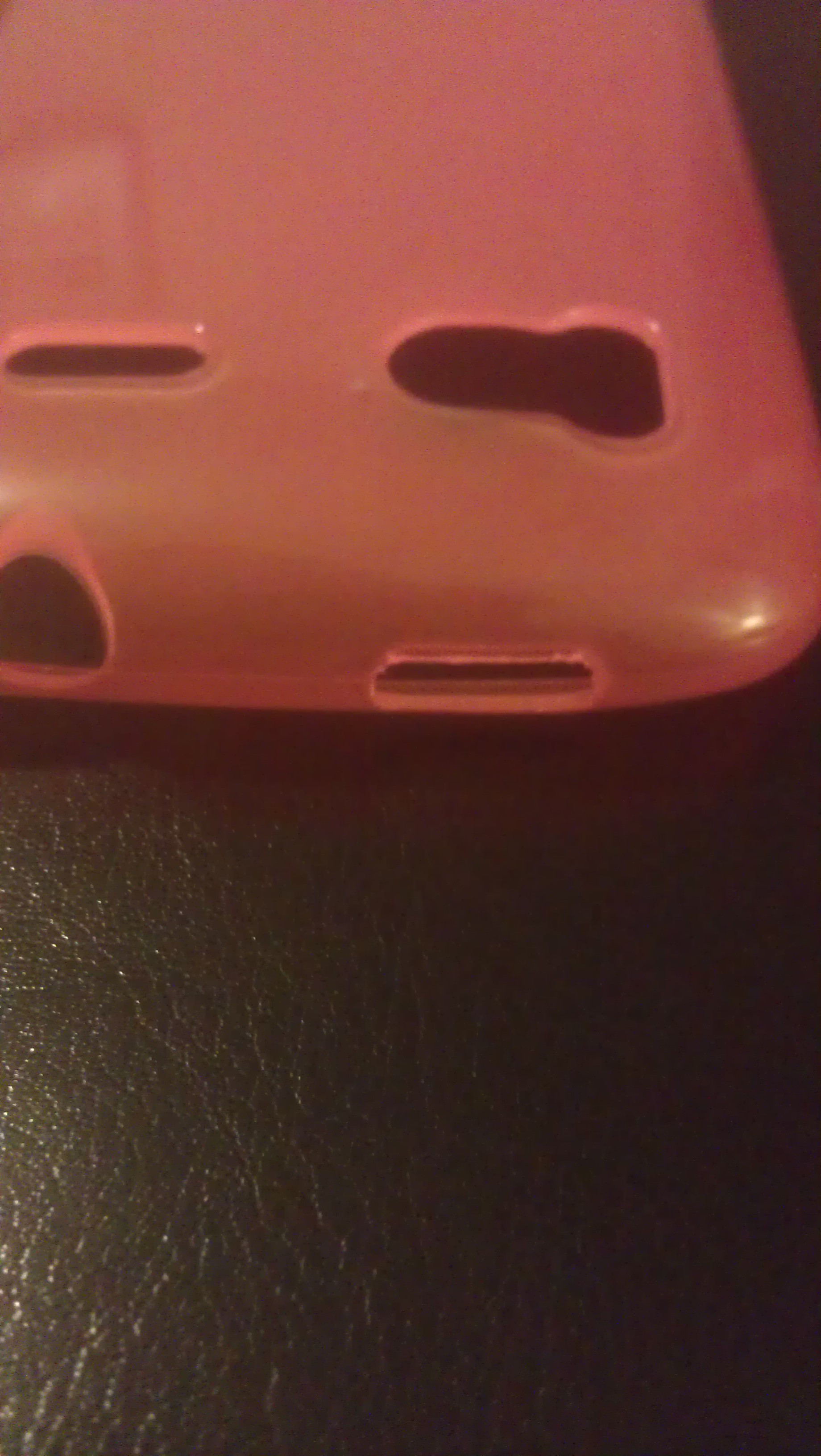

I had the same problem, defo the gel case slightly depressing the power button resulting in the screenshot feature of 2.3.4 being activated.
FIXED by using a surgical scalpel to neatly remove the section of the gel case covering the power button.
Hope it helps.
