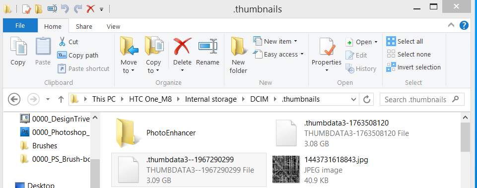

With the "show hidden files" option turned on, you should be able to see the .thumdata files in the thumbnails folder. They, apparently, are the true gluts (source: http://www.file-extensions.org/article/more-information-about-android-thumbdata-files). I've attached a screen grab showing my two files at a total of 6GB (i.e. it's not the thumbnails themselves that take up all the space).
