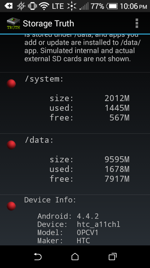

Above is the Storage Truth from my wife's stock Cricket phone. It seems that ~6GB is usable but the other 2 is probably used by Sense.

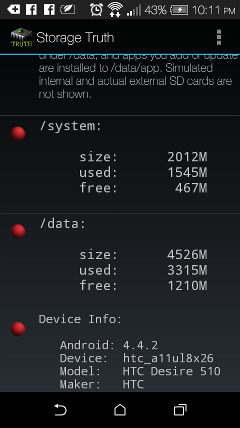

Above is the Storage Truth from my phone. It is stock Boost RUU but unlocked and rooted. I am using rbheromax's new kernel that uses /data on /sdext. I'm just testing it out for now but it seems promising. The 9595M is my 10GB ext4 partition.

I'm a little confused so I hope you don't mind if I ask couple questions.
1) you said your wife's phone is cricket? A11_ul then? But you said something about the Boost RUU and here phone which is where I get lost. But she is rooted with an unlocked bootloader and no other mods right?
2) you are using a custom kernel on your device and built in to this custom kernel is an SD / internal memory swapper? Right? So when you phone lists 10gb of /data the 10gb is a partition on your sd card right? And when you nav to ext_sd (or whatever it is on this device) the space there is equal to what /data *used* to be?
I just always want to read what the other person meant not my own interpretation :)
From the reading I have done, some of these devices had 6gb or 8gb depending on the carrier (just like the 64bit option is only on specific decices) I guess they just figured most folks would never know because they don't delve into their devices that far.

1. Yes her phone is on Cricket. I was talking about my phone when I said the Boost RUU. I used it to get my phone back to stock. I said she is not modded at all, my phone is. Read it again. Maybe I should have had the descriptions above the pictures, they are below them.
2. Yes, I am testing rbheromax's new custom kernel on my Boost phone, the second picture. It uses the sd card for /data.
You're probably right. It seems my device has only 6GB. 2GB for /system, 2GB for /data, and 2GB for Sense. I could be wrong, though. The 64-bit device is sold in Europe/Australia.

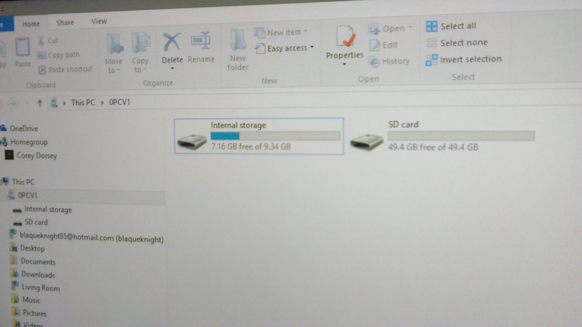

Not done yet I guess. I've been wrestling with this for a while, I think I've got it covered but if you guys wanna weigh in, that would be alright with me :)
My external sd (ext_sd) was partitioned for use with link2sd and since I used this fix I decided to reformat and just have one partition again. Big mistake. You know when they say, if it any broke dont fix it? Yeah..... So, the report ition broke my sd and I had to deep format on the pc to get it back (which was weird because a surface scan shows no errors) and in the process (quite unbeknownst to myself) I lost my nandroid (@#?!&!) and now I need it. Which is fine because there is a stock backup over @ xda (whew!). So I just gotta get somewhere with a decent connection so I can get it in less than a day. None of that is a problem beyond having to re-debloat and reapply the few modifications I've done.
The problem comes in with why I decided I needed to restore. I was playing with Titanium and tried to integrate updates into the rom, and all hell broke loose. Stuff quit, other stuff said "___ needs to be uninstalled and then reinstalled" Google play services disappeared and all sort of other shenanigans. No biggie I though, ill just restore (well we already discussed that). I got a "not enough space" message when I tried to get a backup. No biggie I said, ill just use Titanium to move some of these apps to the SD card and free up some space, or ill change the download directory to the ext_sd and be fine. Nope. Nope. Nope. Not that simple I guess.
The apps that were supposed to go to the SD didn't move... Well it said "batch Operation complete" and should they were moved, but no space was freed and when I open Titanium to check they were still on internal storage. Similar trouble with changing the dl directory.
My impression is that the ext_sd mouthing point needs to be corrected in the vold. Fstab but im not sure of the particulars (because I just copied the other fstab over to the new device, not knowingly made an appropriate and meaning full modification. ... It could have worked though) So this post is two fold. A warning to be more carefull than I was, and a request for some knowledgeable help to save my eyes a little reading :) thanks
