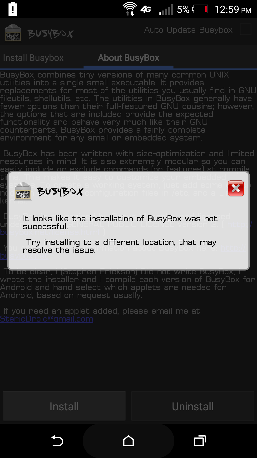

i have an htc one m8
running a rooted unlocked system.
i tried installing busy box from three apps from the google market: busybox, busybox installer and busy box on rails.
when i run the app from busybox it prompts me to pick another location. the original location is /system/bin
if i change the location to /system/xbin the phone reboots itself and upon completion of reboot, busy box is not installed.
the same outcome occurs when i try to install busy box from busybox instaler and busy box on rails.

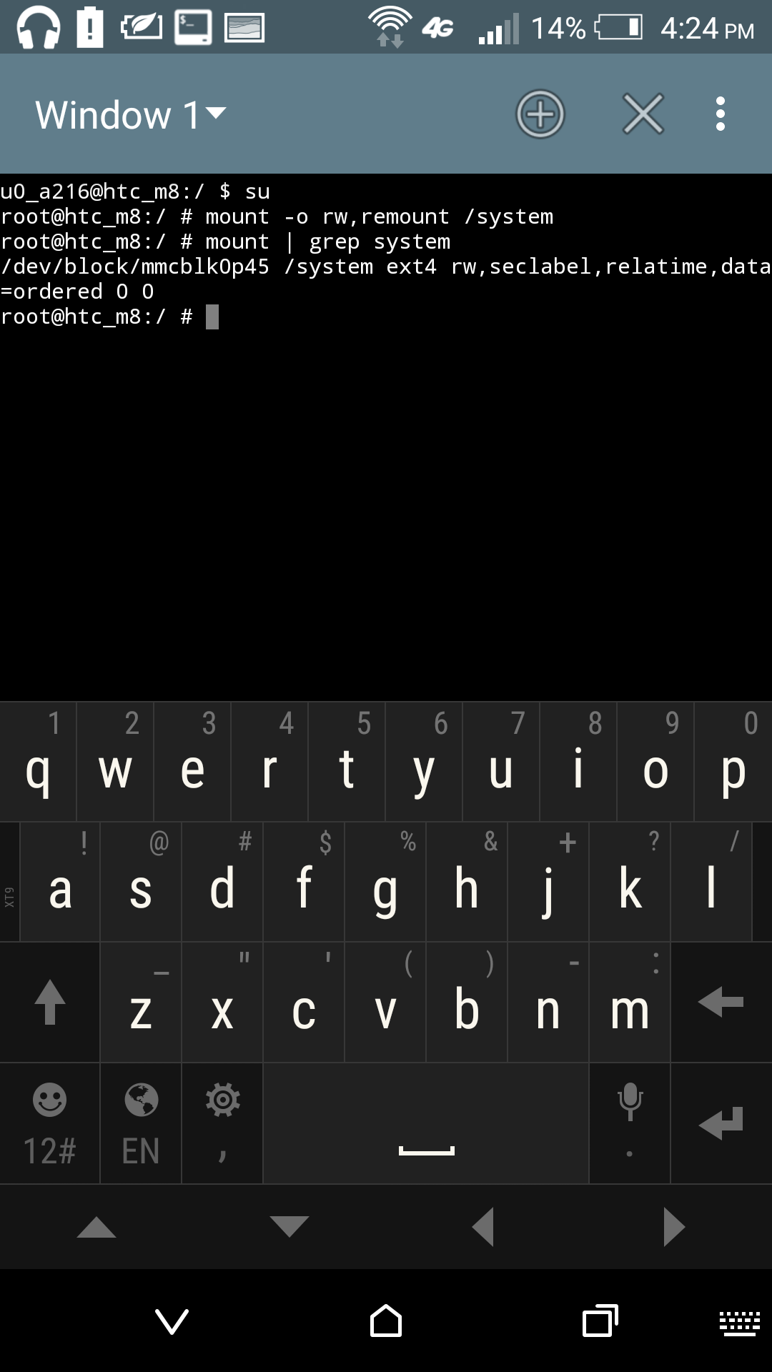

Screenshot_2015-06-01-13-11-26.png Screenshot_2015-06-01-13-00-04.png Screenshot_2015-06-01-13-11-26.png Screenshot_2015-06-01-13-00-04.png
Also what are these commands doing
The ones I gave you invoked root access and then remounted the system partition with read-write access.
Let's add a command to the sequence for verification, and give me a screen shot -
mount | grep system
(I've customized my Terminal, don't let it throw you off ok.)

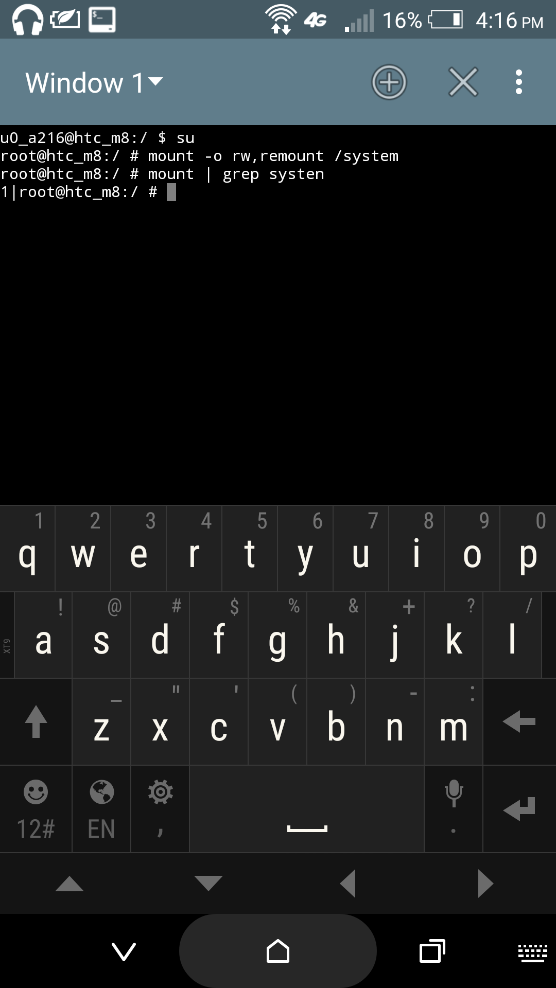

I kinda understand. I'm watching videos from MIT on compute science. They give there lectures out on youtube...
Anyway, hear is what I got.
(There are two things that look like the pipe: |
Only one of them works.
And you have a typo - it's system, not systen.
Try pasting this by a long press in Terminal -
mount | grep system)
Nevermind, you saw it. :)
I just took down and reinstalled Stericson's busybox, no problem - so we know that the installer hasn't gone sour.
How about a screen shot of the busybox just before you do the install button?
Are you stock that you rooted yourself or is it on a stock rooted rom that you flashed?
Don't use hasoons for anything else, it's not your friend.
After this is sorted out, let's get together and install a proper TWRP on your phone.
Yeah - from the screen shot of just the busybox screen, that's exactly what I had. And the install from there fails?
Are you KitKat or Lollipop?
that would be great.
What it's TWRP?
I just tried out again and it fails; giving me the same message add before.
