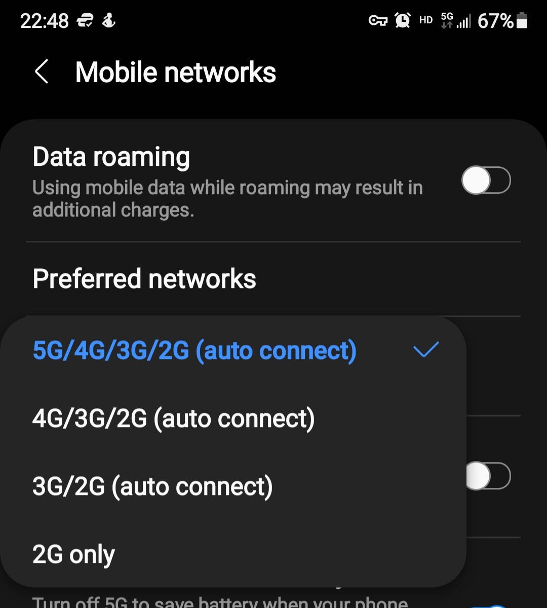

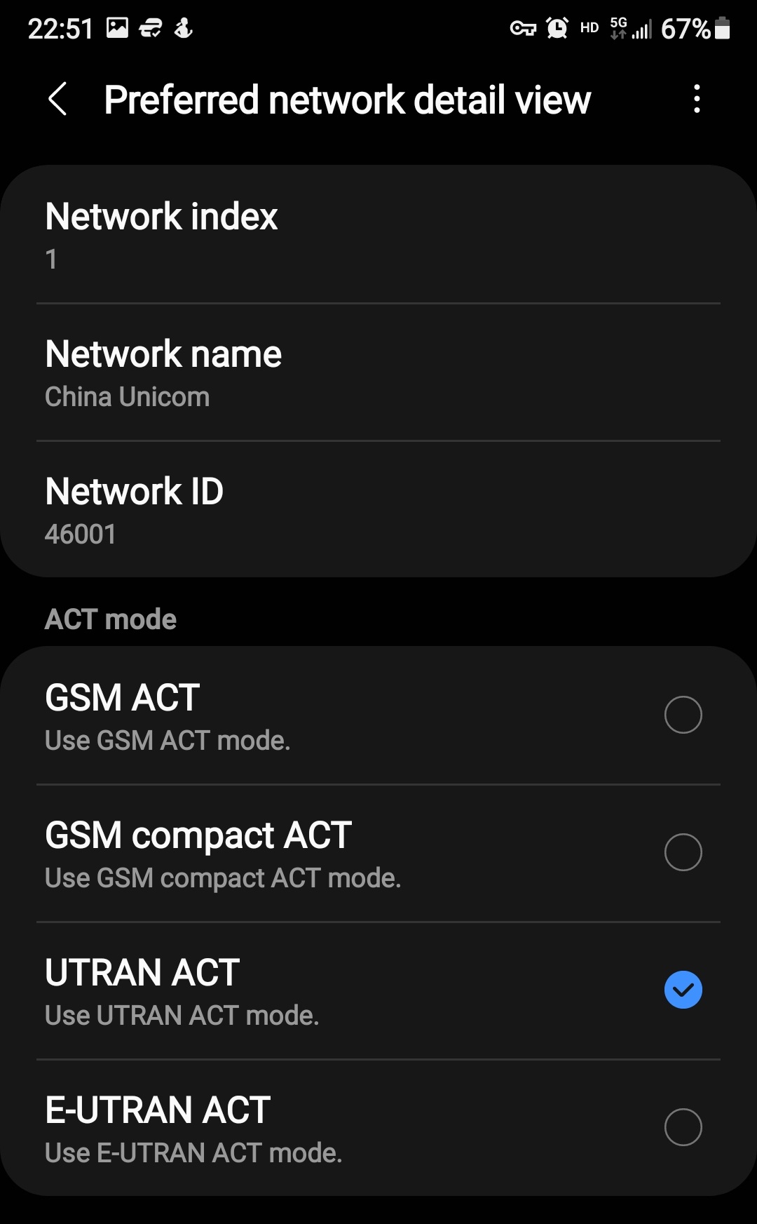

This is what I have on my Note20 Ultra.
If turn it to 2G only, then there's no service at all, because my carrier no longer operates 2G(GSM).
