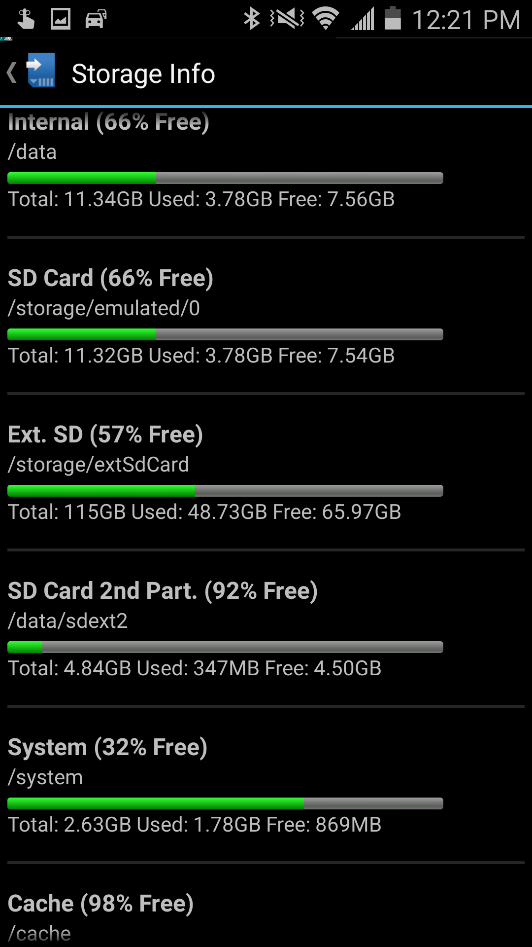

I added a picture showing you all the available spaces..
Any light in this problem¿
So I guess removing the sd card, not good any more???
