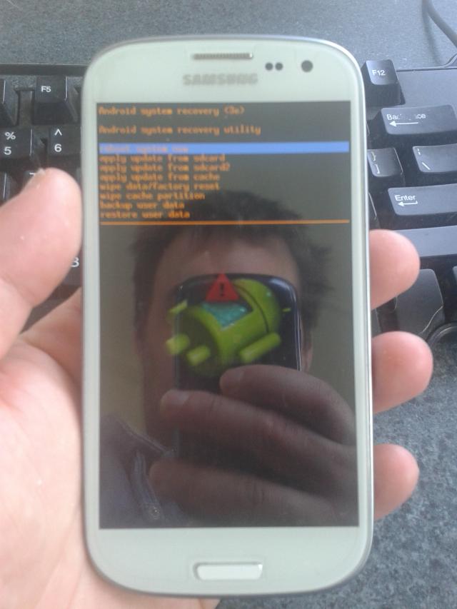

HI, I have a Samsung S3 replica that i have put a custom rom on but half way into the install it turned off (not due to battery) but now it will only run in Recovery mode. I have asked this before but no answer so im doing this again 6 months later to see if anyone out there knows what to do.
someone said to buy a jig and force download mode. this is not the case as this does not have download mode. i have got some other roms and zip files but no luck. hope one of you can help me out.
will put photos up of phone.

That recovery you show there looks like the stock recovery??
What method of root did you use? And did you try to put a custom recovery on it?

yes this is a replica phone not a true I9300, no there is no Download mode at all - unsure why this is even with a Jigg. method of root was clockworkmod with a custom rom - unsure of what it was due to phone not booting os system.

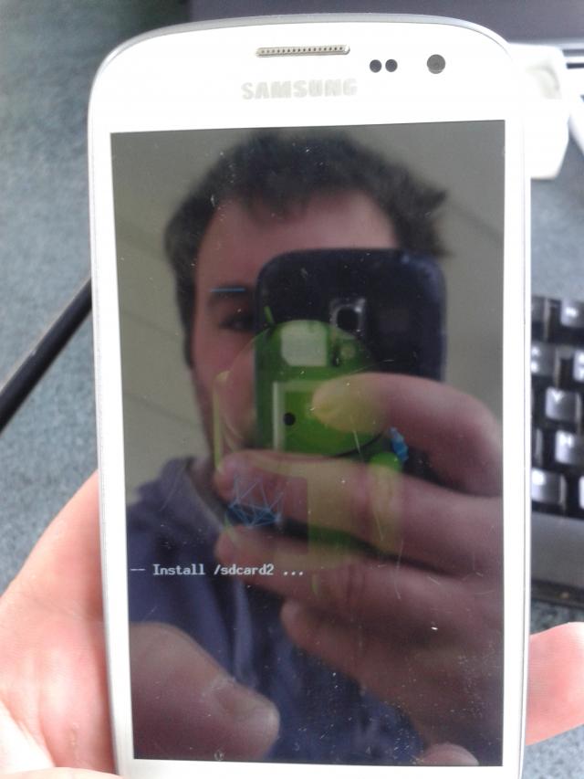

Without a custom recovery, not sure if you can flash a rom, but from that recovery you have there, can it see the sd card?
yes i can see the SD card as i have been putting roms and zip files on there trying to find anything that will make this work. as per photos

Yes this is correct as kies does not recognize the phone and the same is said for odin. I have now found the rom I need but unable to flash it due to not being able to use the middle button to get recovery mode working . Lol. All the apps I need root permission plus the apps I have downloaded like quick boot wont boot recovey. So close.......
on a good note i was able to root the device with Impactor_0.9.14. the bad news is i can not boot into recovery mode screen because you have to use the home button for the menu to load. the rom i am using does not let me use this key at all (dumb). i have used quick boot and other boot tools but none seem to let me passed that android man on his back. any idea would be great. cheers
