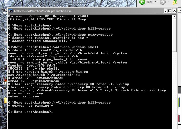

This is the latest attempt to root.
This is what the file says now
"* server not running *
The batch file cannot be found.
Just erase that and then reboot?

dude your almost done maybe another 10 min and you shoudl be set ....you already have root you just need to flash the recovery img and then make a backup and flash a rom
I started over at step 9 using one of the guides and flashed the recovery image as instructed. Then booted fresh 1.1 . I think I'm good to go.
