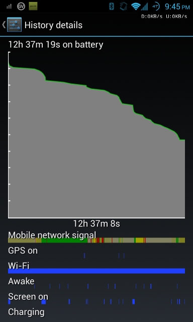

Last night before I go to bed.....
I am using CM10 and this device is a galaxy note lte (n7005)

We can all get better (and worse, of course) battery usage if things are configured appropriately. Having decent battery life and a task killer doesn't mean task killers are good. The point is more that if a task killer improves anything, it's better done another way or there's a bad app. But generally, they are more likely to worsen performance than improve it if anything at all.
edit: If you use Better Battery Stats linked above, you may find the reason why your phone is awake more often than mine (and probably using more battery as well). I wouldn't be surprised if your battery booster was the cause, but I don't know what it's actually doing. But if something is syncing more often than you need, for example, it would be obvious and you can probably improve your battery life better by seeing what's actually using the power, rather than trying to constantly clear memory.

Thanks. I will try better battery stats and observe if it will save my battery

I posted it specifically because the OP was worried about battery drain when the phone was off, and he suspected it was wifi. I usually keep wifi on and I don't get rapid drain, so this app will help find other causes of battery drain when the screen is off. Your screenshot shows that your phone is awake quite often when the screen is off, and you can find out if it's for a legitimate reason or something that you should fix to improve battery life.
