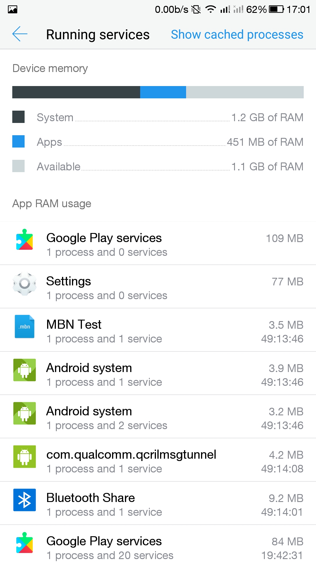

Have you enabled developers options?
If not, then do so.
Inside there is a way to see all running apps.
Check these and make note of what is normally running.
The next time you get the issue, go to developers options and check the running apps.
When you see the oddball that wasn't usually there, that is possibly the culprit.
Hi again puppykickr, I am hoping you may be onto something with the developer options suggestion.
I just had the popup appear so I checked it out, but I couldn't see anything out of place in the running ap
I just did that (I remembered how from my last phone) Im sort of looking forward to it happening again so I can check it out!
I thought I had it, but it looks like my phone objected! I waited for it to appear, checked running processes but couldn't see anything out if place as far as I could tell. I had a look at cached processes and found the following:
They came out in the wrong order lol! I stopped it anyway, and returned to what I was doing, all pleased with myself, but it didn't last long. I got a flurry of 3 popups, and when I checked it had reopened itself! I closed it again, and I will reboot this time and see if it takes.
