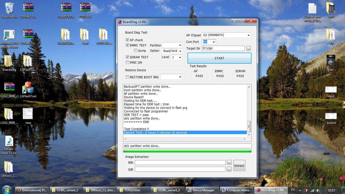

The ultimate bailout plan and my final idea...flash everything with the 9008 tool using "restore boot" option. Start with Primary GPT, then do all the others ending with System as the final one. If that doesn't work, I'd say the eMMc is the problem.

sometime the emmc pass, and sometime the emmc fail (show error) ...

i think that the phone have problem with the memory, that is why i can't flash and go into download mode ... :/
i think that when i force 9006 or 9008 then the phone have the memory(30gb) but when i restart the phone i think that the memory is lost ...
