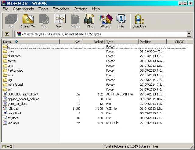

First question; is backing up /efs necessary via Root Explorer? I just completed a Nandroid backup and noticed it also backed up efs. I've copied it to my PC and see a file 38kb called efs.ext4.tar so I assume this is the same /efs you ask us to backup via Root Explorer. Attached a screenshot of the file contents.

Next question. Should I be making regular backups with Nandroid or Titanium? I'm assuming I only need to make a Nandroid backup before and after rooting and/or flashing ROMs, whereas Titanium is for regular backups of the file system. Is this correct?
That is indeed, your /efs file.
