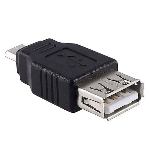

I found these OTG USB to work Great in my one
I have about 4 of them laying around with different sdcard flash drive combinations.
http://www.amazon.com/dp/B0023FTRUO/ref=pe_385040_30332190_TE_3p_M3T1_ST1_dp_1
Be sure and click where it says more buying choices and pick a US shipper else it will take some time coming from china.
I'm actually in India; I've ordered an OTG cable, though I'm not sure if it'll work well or not, just in the hope that it will.
have you used them with a flash drive? is it just neccessary that the drive be formatted FAT32?
I've used such things with ordinary flash drives with their default formatting (which will be fat32).
yeah they work with fat32 flash drives fine
I do have one 64gig Memory Master flash drive formatted NTFS that the phone won't read.
Well I have to correct myself
I reformatted the 64gig drive to exFAT and it works fine also
I also have a couple of these it's a great combo
images
Wow and their on sale again $17
http://www.newegg.com/Product/Produ...m1629X829050Xfaff32208ac96b06c869c98d253a9004
