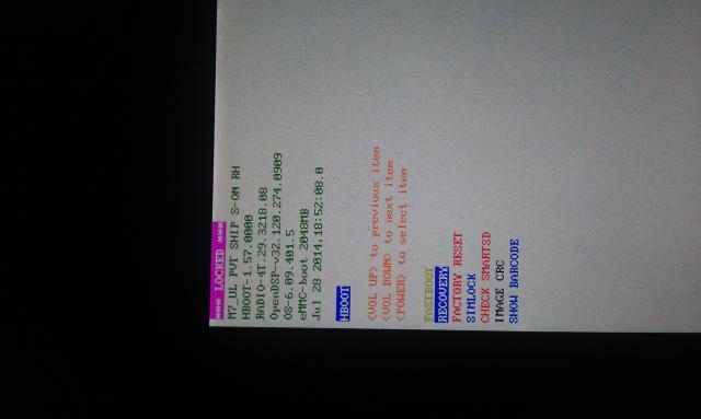

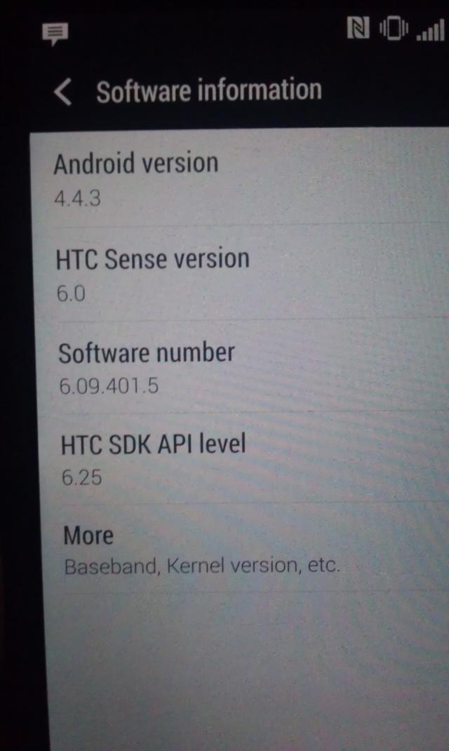

Hi guys I recently updated my HTC One over wifi through the update function from within the phone and now I'm seeing all sorts of problems.
It's a factory unlocked phone so I can use any SIM card and I updated to Android version 4.4.3
Battery drains much faster ever since the update, the phone has been sloggy and sloppy at processing anything and the Volume Down button keeps showing as being pressed even though when it's not, due to which the phone sometimes restarts in Safe Mode and sometimes in Bootloader and it takes ages to get out of there.
I've tried soft resets and hard resets and a few other tips but nothing has worked. So I was thinking that it would be best to downgrade to an earlier 100% working software version, whichever you guys recommend.
Please check the attached images of my phone details and guide me how I can go on about doing this whole process, or if it's easier you can point me to relevant threads/posts of similar nature.

yes, if you are s-on you can only run an RUU which is the same version or higher than you already have. With s-off you can run any version. Also with s-off it is really simple to change to super cid to run any RUU you like.

you have the newest software ..all you can do is boot to stock recovery and do a factory reset

Sorry but i thought I made it clear ...their is no 6.xx.xxx.x RUU for your phone. If you want to use a RUU you need s-off because the only RUU is older than your current software. The Factory Reset in the Stock Recovery is different than the one in the bootloader and in the settings menu.
reboot the phone to the bootloader use volume down to recovery, hit the power button. when the screen goes black or you see a triangle on a phone push volume up and hit power at the same time. this will bring up the menu in the stock recovery. you'll see sdcard error 5 times, this is normal. from the menu choose to factory reset / format data. when it's done your phone will be the same as new.
Think your out of luck with the ruu as you took the ota update. I can't find one either. You have two choices, either s-off and run a lower ruu, or root and install a custom recovery and custom rom.
