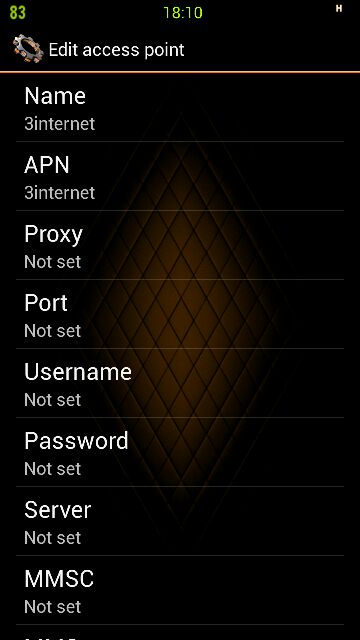

Just make a new apn, name it anything and make the APN 3internet then save it
