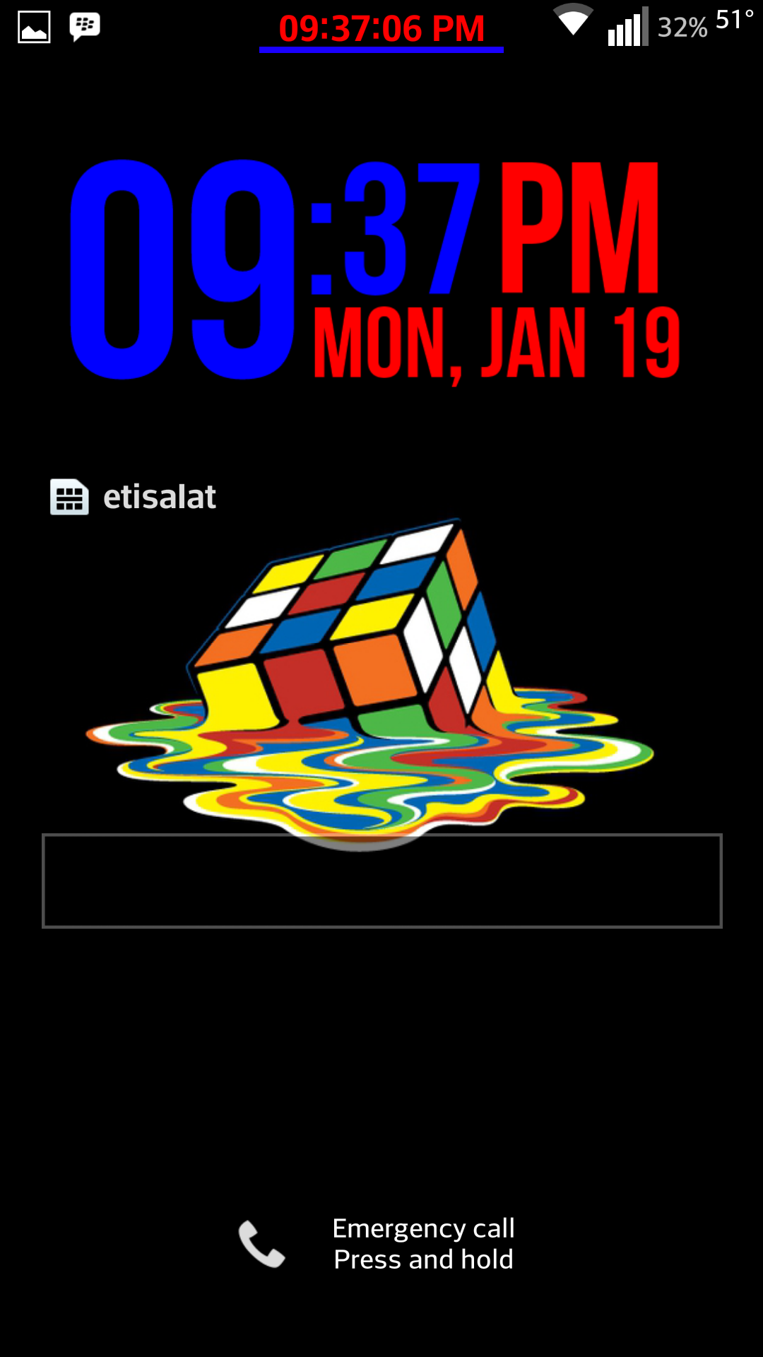

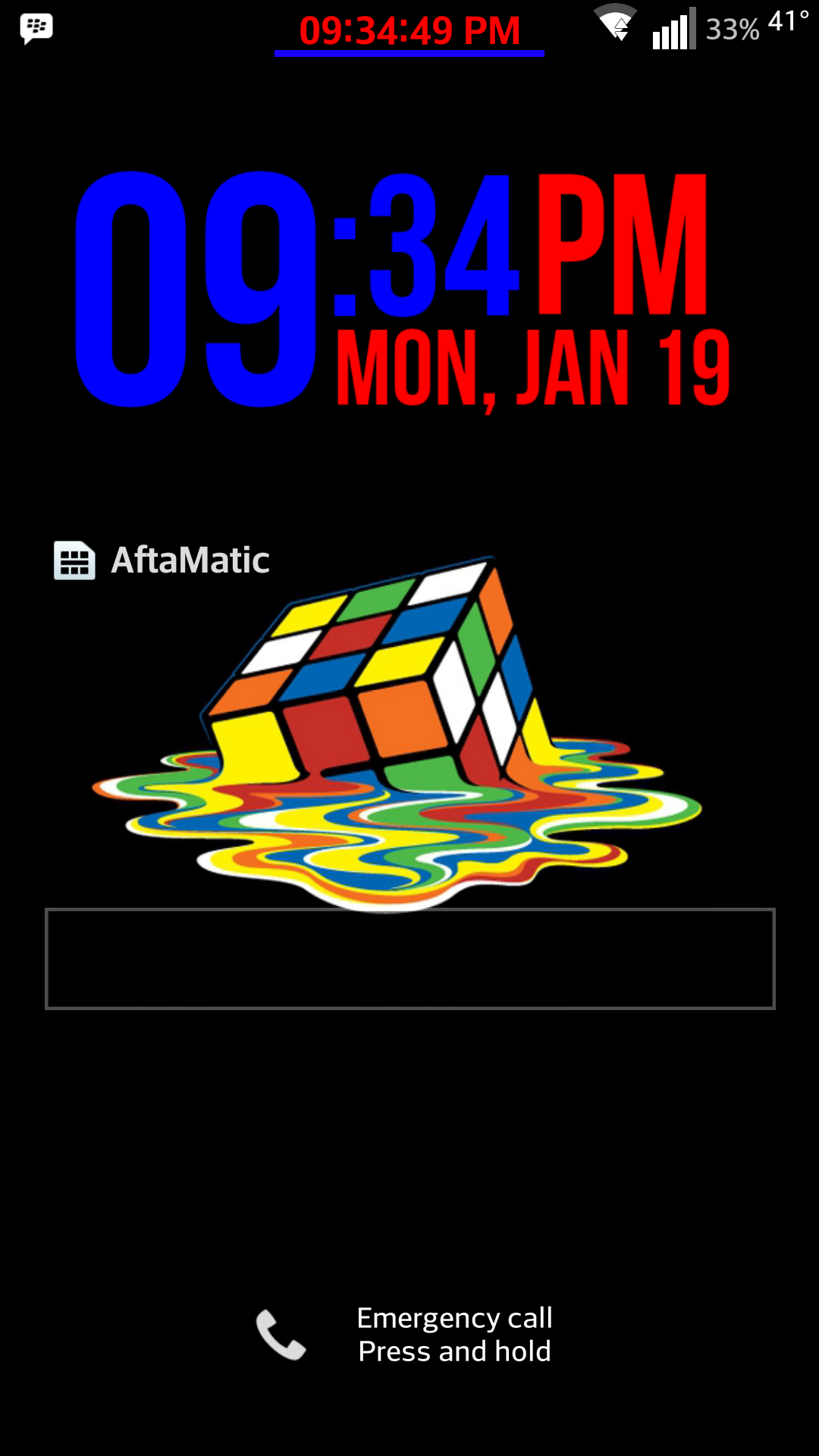

I have even attached screenshots of what it was for me BEFORE and what it is now AFTER. (My default carrier name was 'Etisalat', btw)
