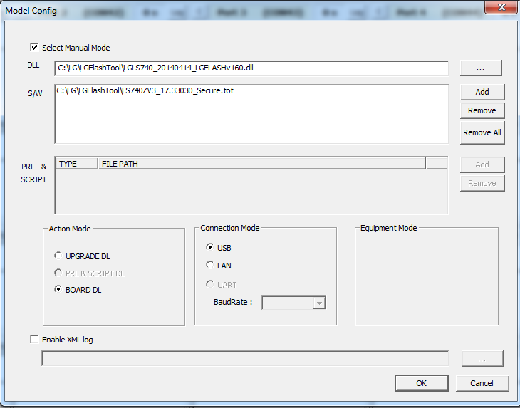

I was trying to update the TWRP version on my Volt and I did a bad move, so now my Volt is corrupted and the only thing that I can boot is the Download mode. (I made it a brick).
I'm having problems following the procedures with LG FlashTool that I found on your website:
http://androidforums.com/threads/guide-brick-recovery.893332/
http://androidforums.com/threads/official-restore-with-dl-mode.853693/
Every time that I try flashing I get a "Device Model Is different" error. this is what i get. What I'm doing wrong?

Make sure your config looks like this:
Thank you Spock1104. I verified the configuration, I even moved the files to the same folder as you but I get the same "device model is different" error... It is possible that there is any difference for the "X5" models???? The USB driver seems right too...

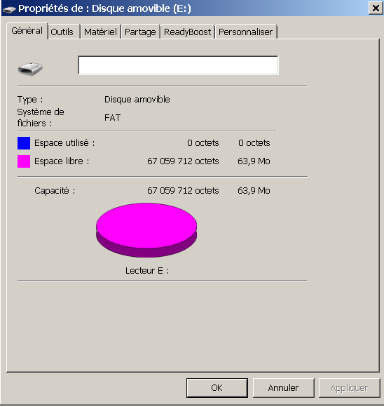

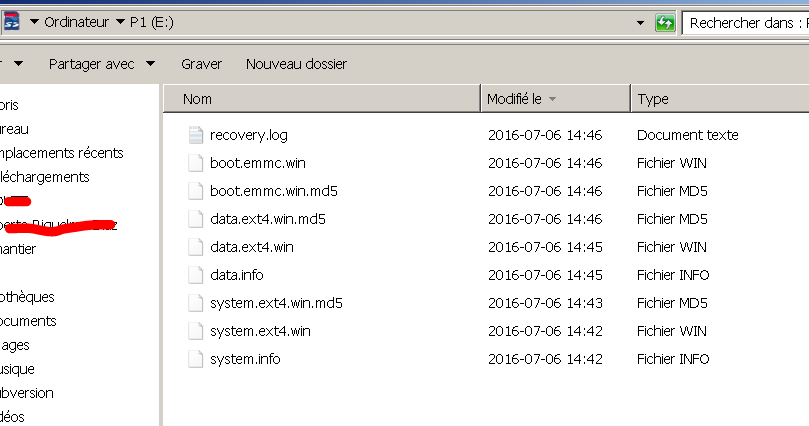

Thank you very much Brand N and sorry for the late answer. I had to do a quick travel so I couldn't give a try before... Anyway I was not succeed doing what you advised me. This is what I did
I've made a backup with TWRP before bricking my phone. It's around 2.7G. I made a 2.9Gb partition on my SD and I made a copy of all the files inside the TWRP backup folder (it says that i have 68Mb free after the copy. This is how the backup files looks like.
(All the rest of the SD i left it "unpartitioned", so I just have one partition.)
Then I've boot my phone in Download mode
Then, I've run the Send__Command
Send_Command.exe \\.\COM41 (I left the same port number as for the LG Flashtool process)
then I did the command that you told me:
cat /dev/block/mmcblk1p1 > /dev/block/mmcblk0p17
after this, nothing happens.
Something that I've realized is that when I connect the phone without the SD there is one "removable disk" of 64Mb that appears. It is empty. There is something that I can do with that??
Thank you again!! :)
How did you prepare your SD partition first? On linux, I would size the partition to ~15MB, then cat the twrp recovery image over that partition. It looks like what you did was copy the recovery files itself in there. That's not what I meant. I mean, put the actual recovery image that you want your phone to boot as a raw image into that partition, so you can slide it straight from there into the phone's recovery partition.
Also, if the phone is in a recovery mode presenting its internal flash to the computer (you are probably seeing the one FAT16 partition on it - the modem firmware partition), you could use a drive imaging tool to copy a raw disk image over the phone's storage. I made a flash dump once for someone but I think I deleted it. I could do it again if you need it.
I don't recommend trying that yet, but it is an option.
Hello Brad N, I'm back in town again and I've tried copying the twrp img into the phone. I've created a 24Mb partition (on windows this leaves me a bit less than 10Mb of free space, enough for the image). When I do the cat /dev/block/mmcblk1p1 > /dev/block/mmcblk0p17 nothing happens (The Send_Command.exe \\.\COM41 works without problem). On the cmd I see the same as when I tried to copy the backup image (nothing after the command). Even the progress bar on the phone don't move. :(
I guess that I bricked it badly... :spitoutdroid:
Ok, I've got a bit more experience with download mode now. The way you're trying to do it can be made to work but it's different than what I originally wanted you to do. Let me try to explain.
A partition can contain a filesystem, or it can contain... something else. When you format a partition on Windows, you're creating a filesystem. I didn't want you to do this.
So, normally a disk contains partitions, a partition contains a filesystem, and a filesystem contains files. What I wanted you to do was create a partition, without a filesystem, with one file written over the partition, starting at the very first sector of the partition.
What you tried to do was create a partition with a filesystem, with a file stored somewhere (we don't know where) inside the filesystem.
But, I found out that if you have a fat32 filesystem in the first partition, download mode seems to mount it automatically. So it turns out the way you were trying to do it can be acceptable. You would have to change the command like:
cat /storage/external_SD/TWRP-filename.img > /dev/block/mmcblk0p17
But... we shouldn't be doing any of this stuff. If you see a storage device from the phone when you turn it on, I think something else is happening. I don't think it's running download mode (do you see the "Firmware Update screen and circular arrows and "ROOTED" at the bottom?) If you don't see this stuff, it's not download mode, and trying to cat the recovery image like such won't work. In addition, if the phone's modem partition is showing up and it's empty, more is broken than the recovery.
I think we need to restore a whole 7.5GB image of the phone. But I think that can be done if it's showing up as a mass storage device. It's easiest to do that in linux, I think, but certain disk imaging tools should be able to do it in Windows as well.
