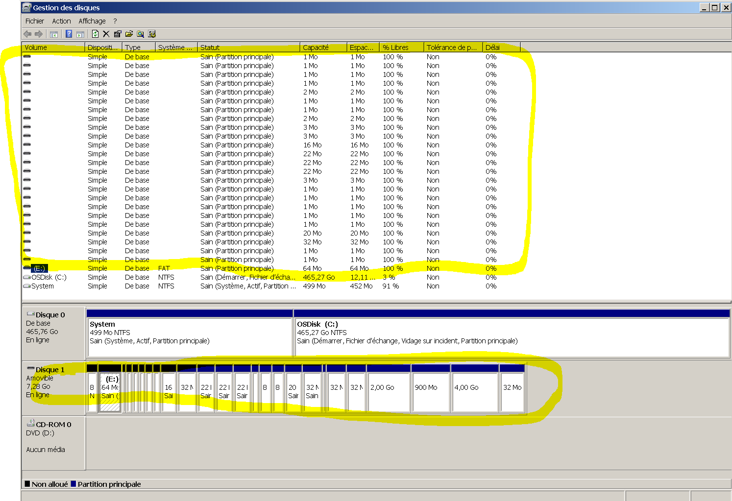

After Opening the Disk management Console I see this about the unit (full of different partitions). Sorry for the text in french...

EDIT: I didn't see that the second step was the destination unit in the HDD raw copy tool.. I'm trying to do the copy into the SD memory... this is the progress so far

The copy is finished. It created the sames partition on the SD, but no way to copy everything into a single file....
