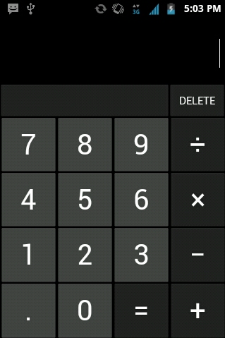

  • New default gallery app - Gallery ICS by Moblynx
  • Ics Keyboard (Go to Settings/Language and Keyboard to enable)
  • Ics Calculator Don't update the app in the google play store unless you love ads
  • Silent camera (Not silent in 3rd party camera apps, working on this also)

Power and Weather widgets are ics themed
