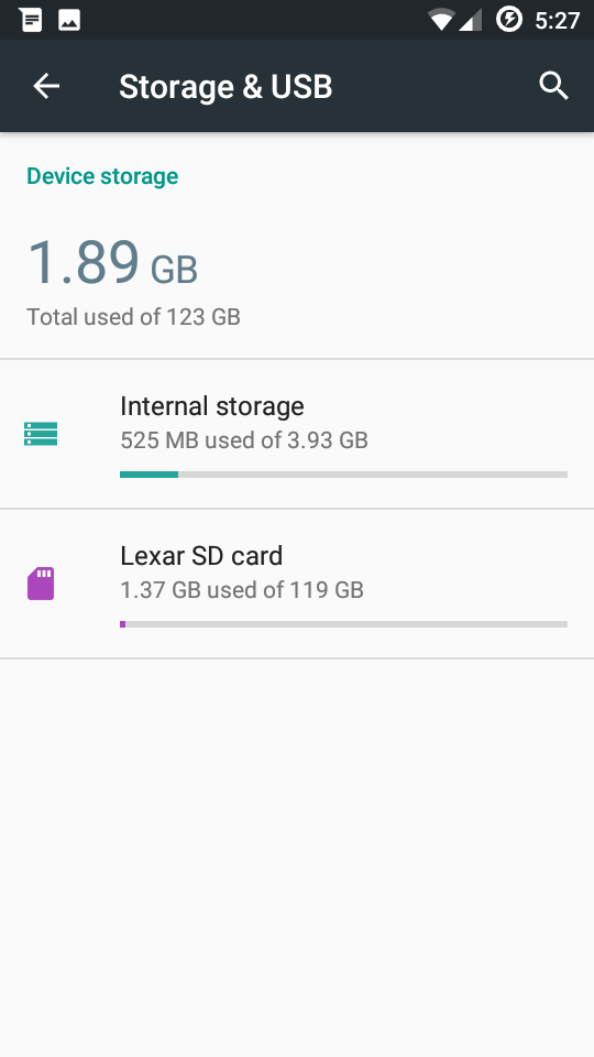

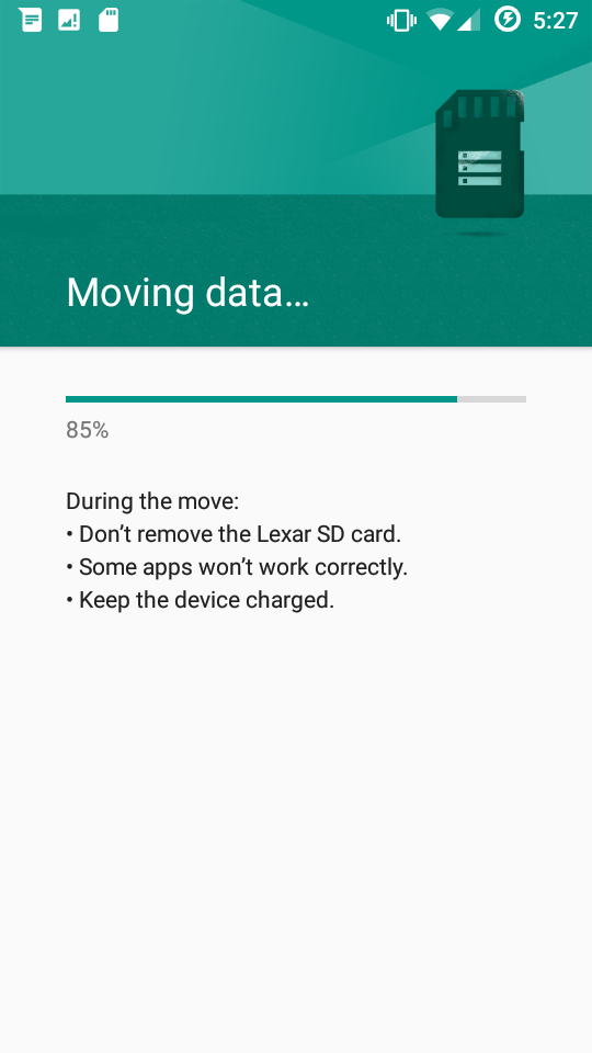

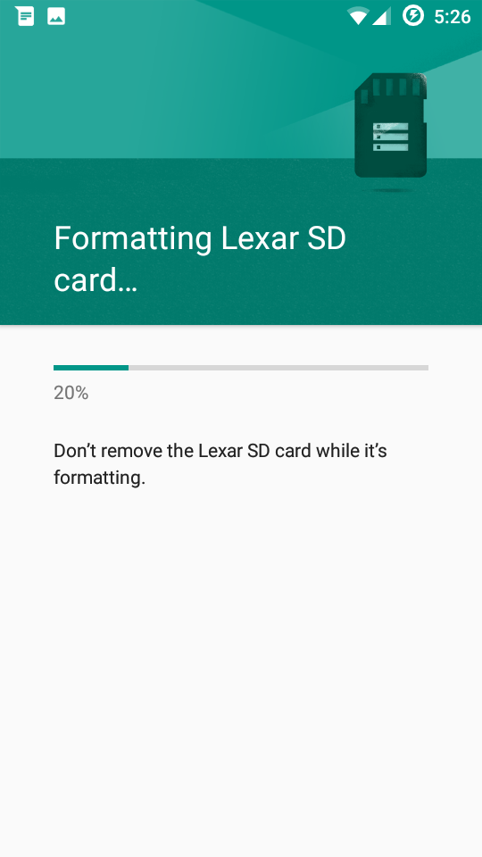

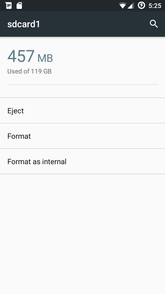

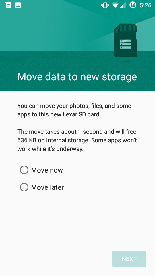

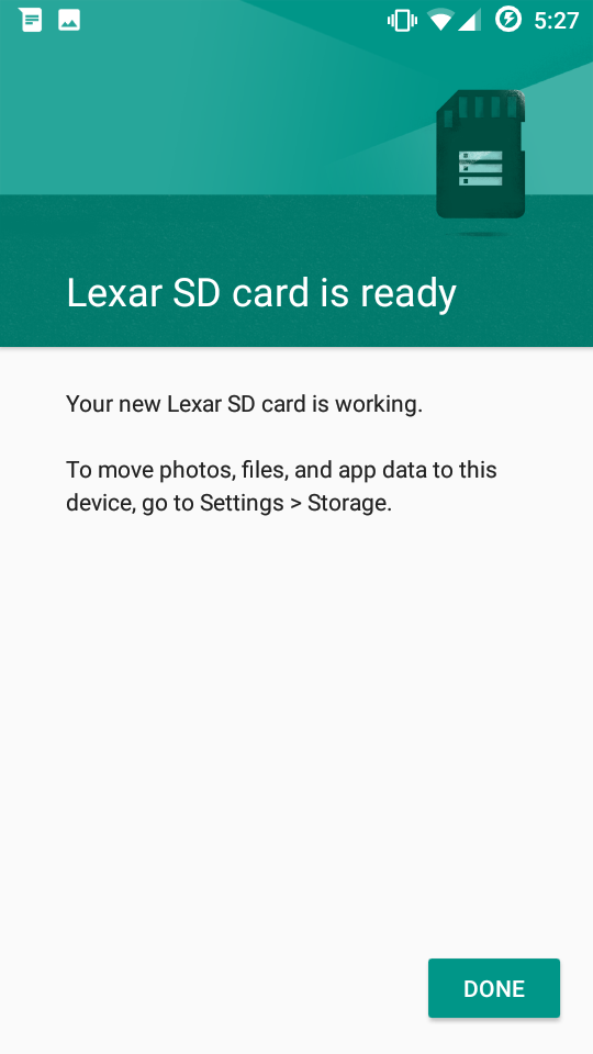

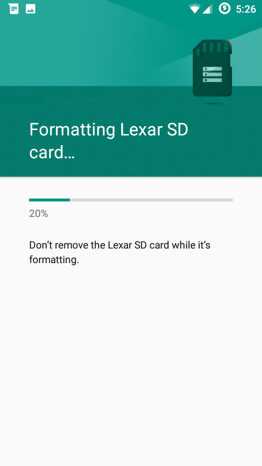

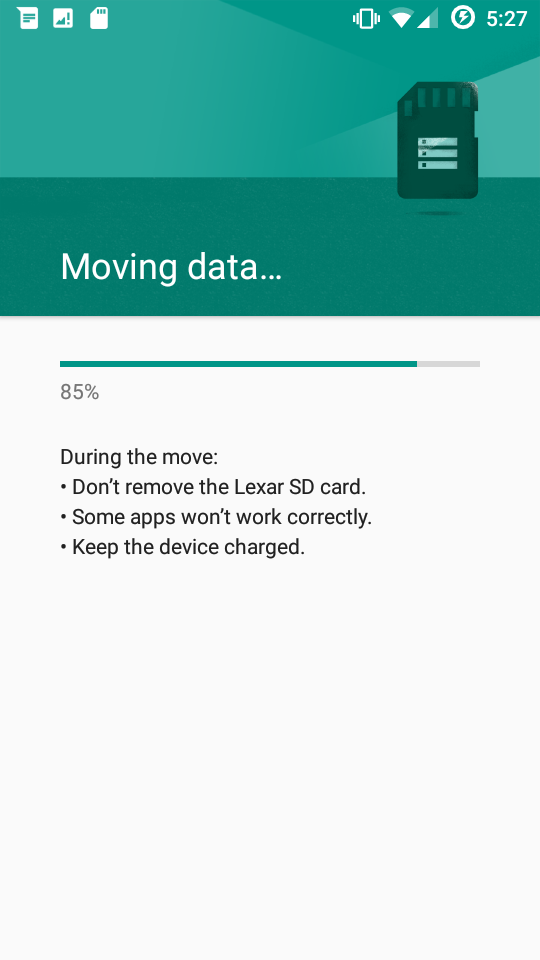

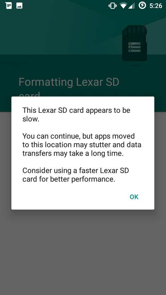

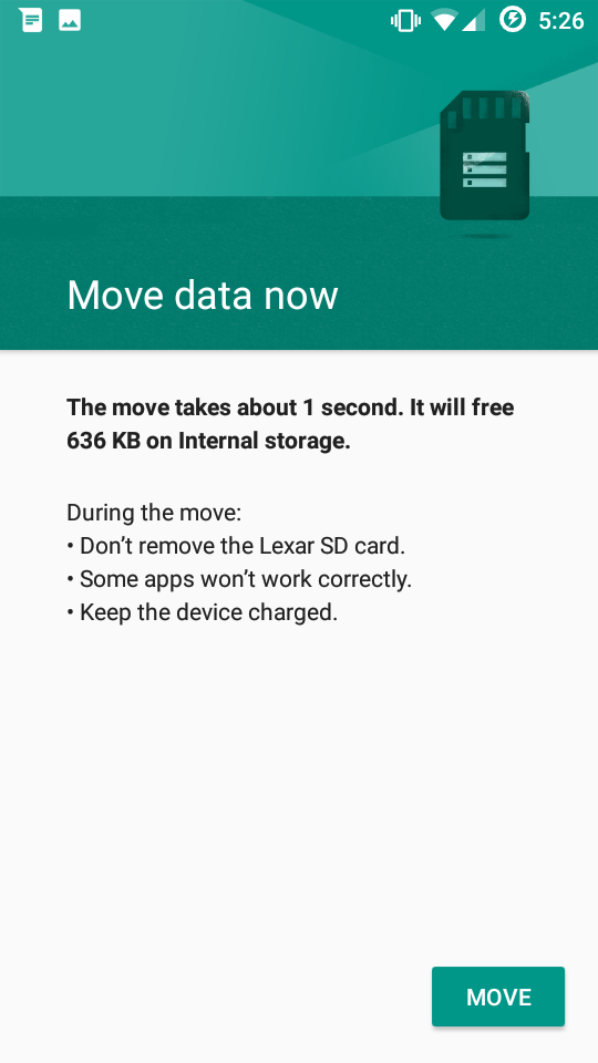

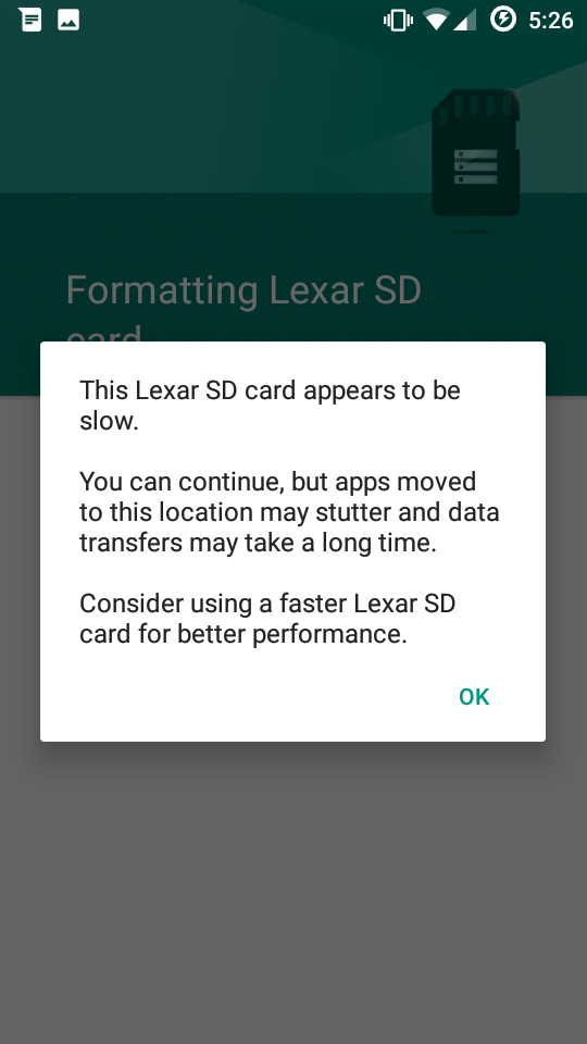

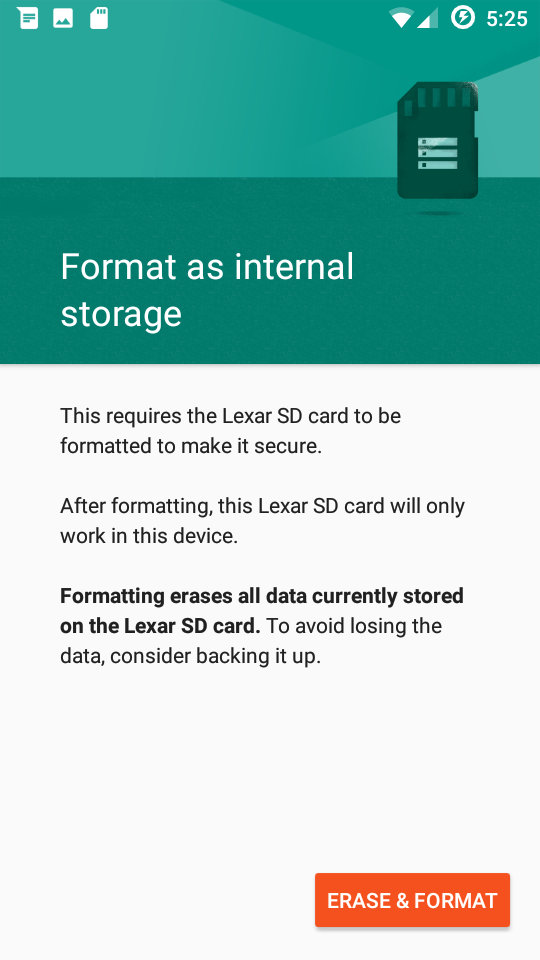

Unified storage appears to work here! Yes, no more awkward multi-partition stuff like with Link2SD. It however incorrectly identified my Micro SD as a "Lexar" when it's a "PNY" branded card but that doesn't appear to affect anything. Look at all that nice storage, thank you for the rom @whoshotjr2006

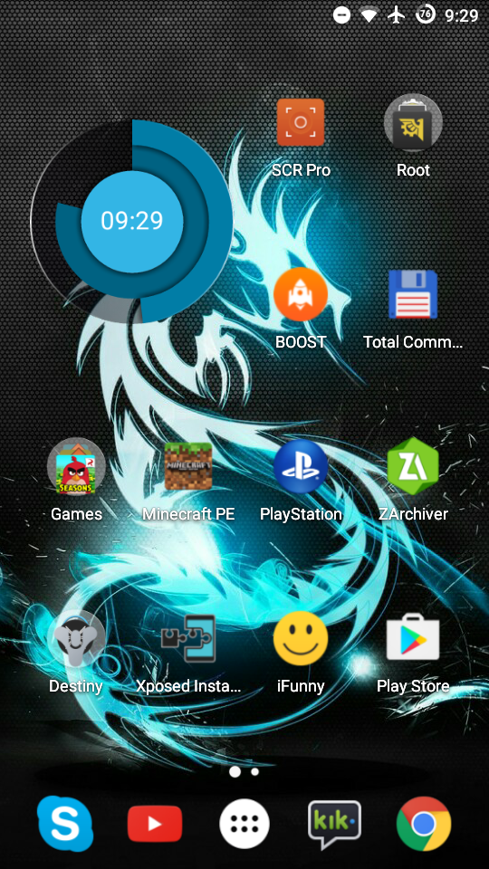

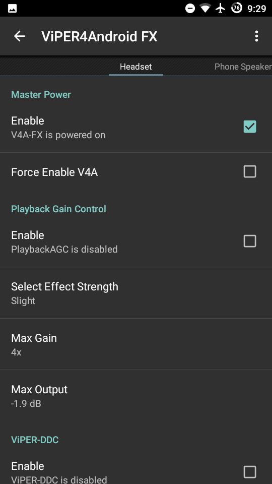

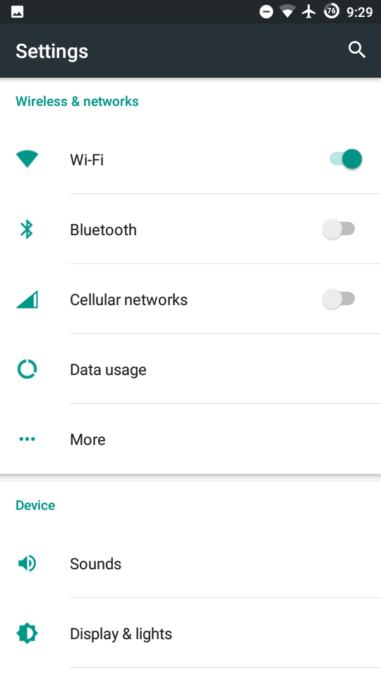

I haven't had any issues with video choppyness so far and I haven't found any issues either besides forgetting to install busybox for V4A but that's my fault, anyways Im just gonna post some screenshots here
