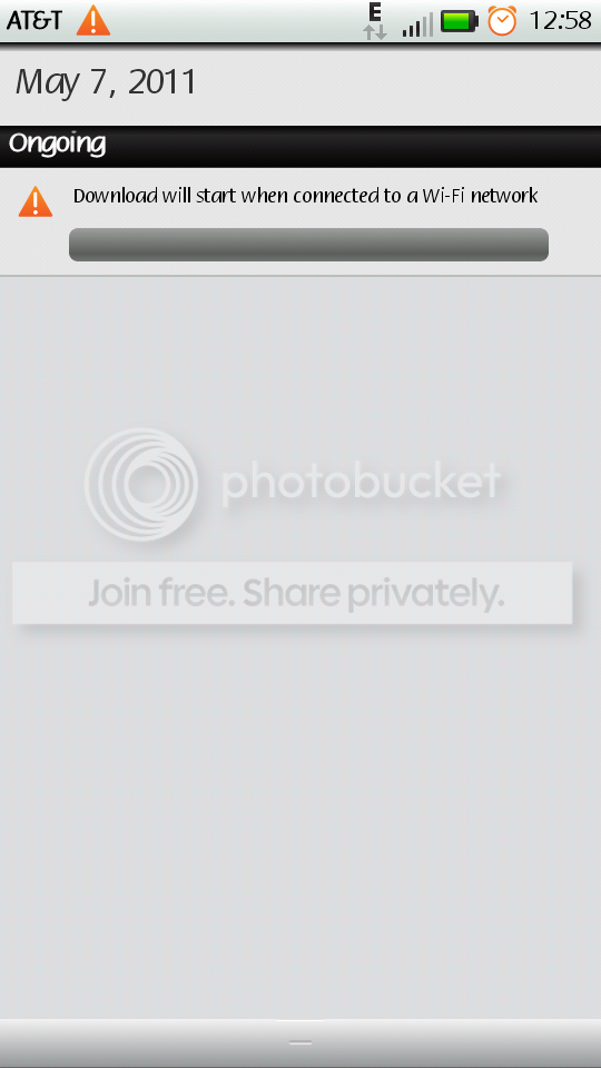

Is it possible? I can't connect to WiFi because it tries to update when I do, only prompted twice then started on its own. There's no process for it to me to freeze, that I see anyway.

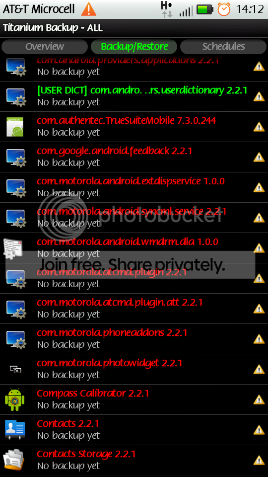

I can't use GingerBreak, my Atrix won't recognize an external SD, didn't notice until after my 30 day return period. And it only showed the pop up twice, then started on its own. com.motorola.blur.updater isn't showing up now or when it tries to download.

[EDIT] This is odd, I am unable to find the com.motorola.blur.updater as well. I found another post that said to freeze updater 2.2.1 (mine says Updater 2.2.2, but I am running 4.1.83). Try that
I'll try it, thanks.
EDIT: Freezing updater took care of it, thanks. Gonna see about the SD tomorrow.
