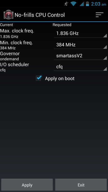

I'm hoping that someone gets working on Cyanogenmod next :)

My recommended settings for the Supreme
Max Clock - 1674mhz
Min Clock - 486mhz
Governor - Interactive
I/O Scheduler - Sio
can be set with No-frills CPU Control

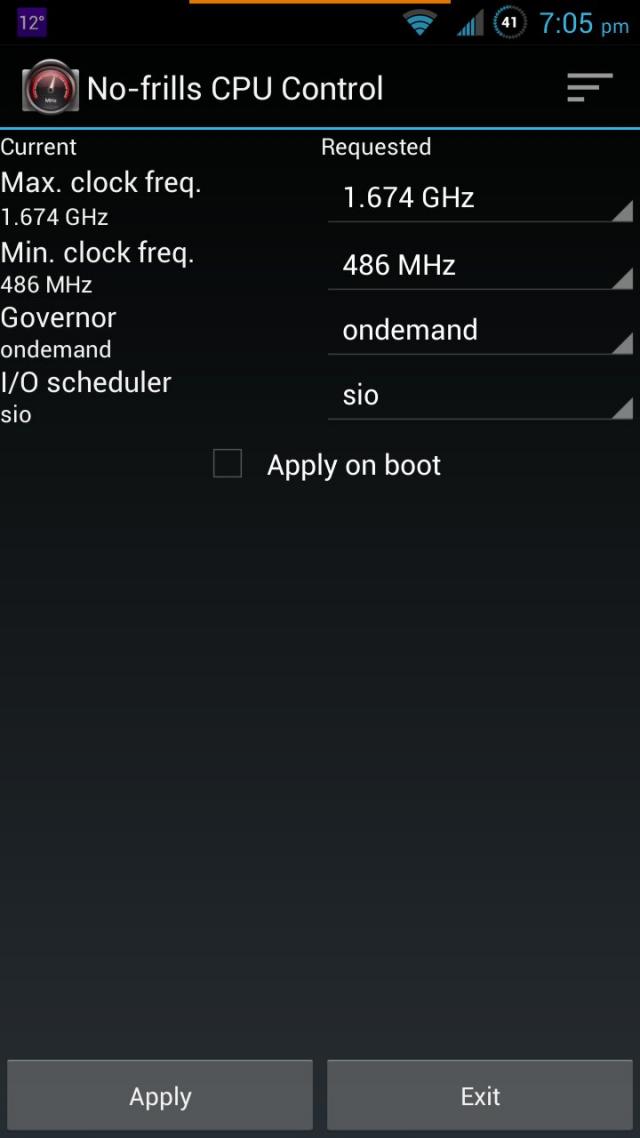

I've been running v4 all day and have had a few random reboots. I'm playing around with the frequencies and I/O scheduler settings to see what is most stable. I ran most of the day at 384Ghz-1.836Ghz and cfq and didn't reboot until I switched scheduler to sio. Trying what was recommended in the first post now.
486Ghz-1.674Ghz, sio
