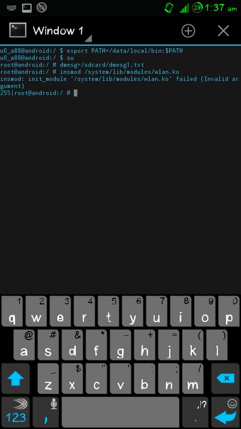

do me a favor people. on the awe go to terminal and insmod the wlan module. then immediately check the dmesg see if it gives you crap. then try the same on the warp or the source doesnt really matter which as its using the oc kernel
How I did it (and I'll update here if it turns out I did it wrong :) )
-Make sure you can use 'adb shell' with your phone plugged in.
After you plug your phone in and type adb shell, execute these commands:
You could also type these on the phone via terminal emulator, if you wanted to.
Code:
su
dmesg > /sdcard/dmesg1.txt
insmod /system/lib/modules/wlan.ko
dmesg > /sdcard/dmesg2.txt
Zip those two files up, and if you could pm them to me, that would be great!
It would be great if you could do it with both the oc kernel and the normal kernel.
This should help identify the issue with wifi.
looks to me like an incompatable module... when you do it on a warp 4g with stock kernel it says failed (file exists) which id assume means its already been loaded...
picture. didnt look at dmesg but im gonna guess it says something about a symbol mismatch
bingo.
<4>[12-17 09:37:47.960] [0][5497: insmod]wlan: disagrees about version of symbol cfg80211_new_sta
<4>[12-17 09:37:47.960] [0][5497: insmod]wlan: Unknown symbol cfg80211_new_sta (err -22)
<4>[12-17 09:37:47.960] [0][5497: insmod]wlan: disagrees about version of symbol wiphy_new
<4>[12-17 09:37:47.960] [0][5497: insmod]wlan: Unknown symbol wiphy_new (err -22)
So, er, what do I need to do? Google isn't being very friendly tonight. On that note, I should probably get my IRC set up again :P
basically its a problem with a value that is supposes to be set to the aame thing in the kernel as it is in the module. and its not matching up
