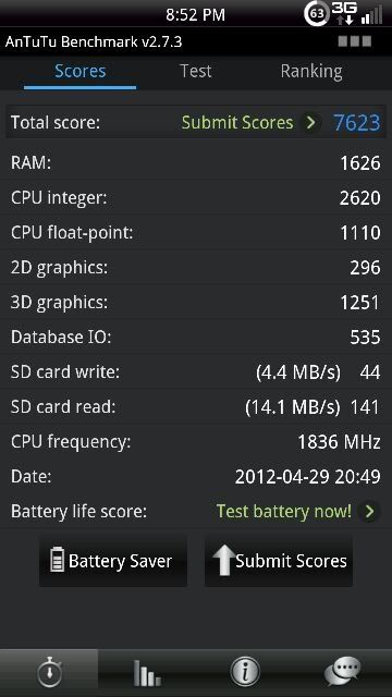

Flashed last night, so far so good. Running the aggressive governer. Best score yet!
