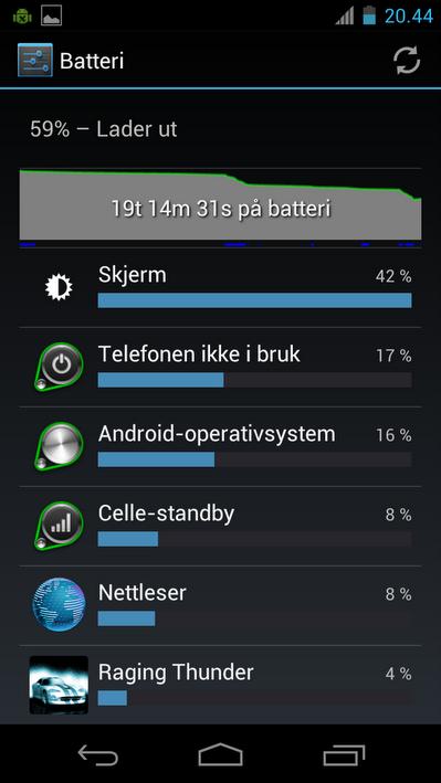

There is definitely something wrong, my GN goes for 20 hrs with
a LOT of use. I estimate it will run for up to 40-48hrs with total savings on...

Do you have 4G on? I turned that off and it seems to have at least doubled in battery life (which is great, but it's still dead in 5-6 hours with moderate use). All of my other settings are fairly conservative when it comes to battery life. I'm trying to avoid taking it back, but will do so if it means correcting this issue. I'm just not positive if it's a phone-specific issue.

At least define "a LOT" with a screen-on time. If you are getting 20 h, I can't believe your screen is on for more than about 30-45 min or so. Screen shots of discharge curves and screen on times should always accompany claims such as this when so many people are barely getting through a work day or less with this phone, otherwise you are making people paranoid without just cause.

I do not have the 4G version. I can empty the battery in 5 to 6 hrs
with light on full , wifi on and continous use. But most of ghe time
light is on auto. The screenlight is the main consumer.
Battery capasity : "1d" = 24 hrs....
"Skjerm" = Screen
This is not the 4G version.
