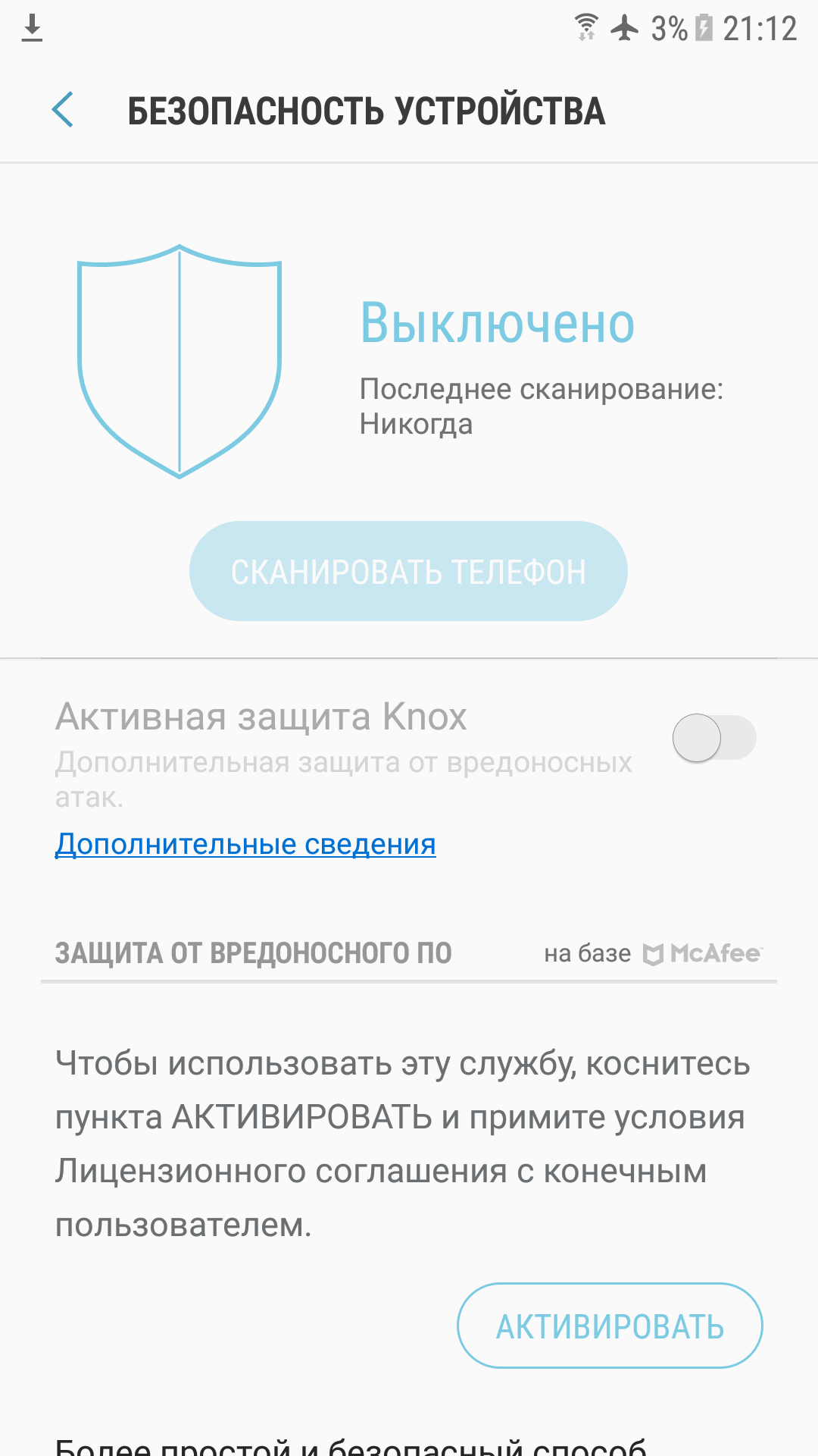

Nice to be here. I ask for help with Knox. I can't activate it. Knox activating button is disabled. Maybe virus or something else. Lucky Patcher shows that Knox is deleted "for that user". What does it mean and how i can activate my Knox security function again?
Thank you!

I presume you've got a Samsung device, and you've rooted it. Lucky Patcher is malware

AFAIK you can't. When a Samsung phone or tablet is rooted, it trips a non-resettatable e-fuse, that permanently disables the Knox security, and voids the warranty.
You can check the Knox and Warranty Void status by going into Download mode. If it shows 0x0, it's ok. If it shows 0x1 or anything else, Knox and warranty are invalid.
what phone do you have? and this is an English only site. i was able to use google translate and this is what your photo says in English:
so you can't select the activate button all the way at the bottom right?
Thank you for answer and additional effort for translation. Yes, button is disabled and where is no way to activate it again. I was thinking that it's my smartphone mistake and there can be some sort of firmware to activate button again. Something like "button: enable".

Thank you for answer. I didn't think that I lost Knox support because my samsung smartphone is rooted.
I put smartphone in download mode (can't create screenshort in this mode).
Download mode shows me:
Odin Mode
Download Speed: fast
Product name: SM-A510F
Current binary: custom
System status: custom
FAP Lock: off
Secure Download:Enabled
Warranty Void: 1 (0x020c)
RP swrev B:8 K:3 S:4
I lost Knox support, right?

yep you are rooted and thus do not have knox......it is a known issue with rooted samsung devices. also you will not be able to use any banking apps as well.
That's why I was thinking that Knox is disabled because smartphone compromised.
As far as Knox is concerned the process of rooting compromises the phone. As others have said, the Knox flag was tripped by rooting, and by design there is no way of undoing that.

And if you could reset the Knox flag then a bad actor could do this as well: modify a phone, reset the Knox flag, then the victim could use the phone for their personal banking or corporate business with nobody knowing that it was compromised. That's why it's designed without a reset facility.
