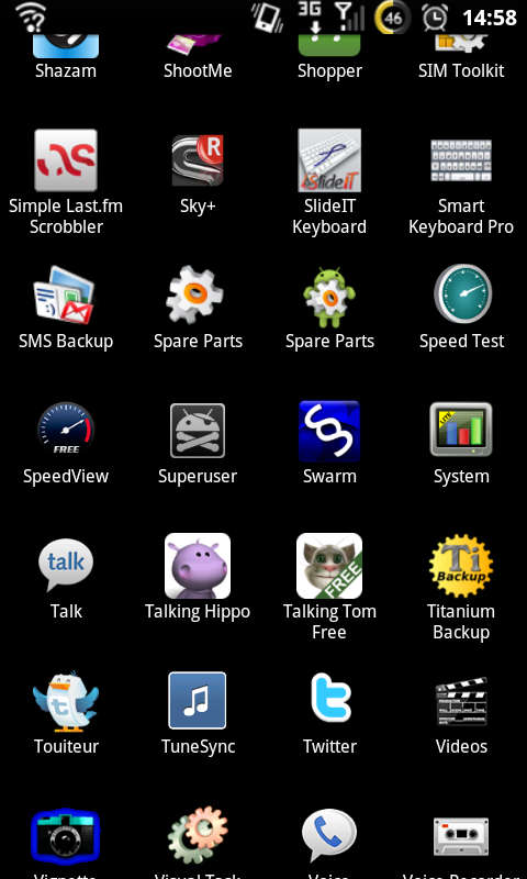

Has everyone seen that you can change the LCD density on the Desire? (Well, on all Android handsets really). It simulates a higher resolution, fits more text on screen etc.
There's an app on the market which does it, although it won't work on the Desire unless you're S-OFF.
All you need to do is extract the build.prop file from /system to your PC (in recovery, use ADB PULL), and using a text editor change the value of LCD Density from original 240 to 200, then ADB push it back and reboot.

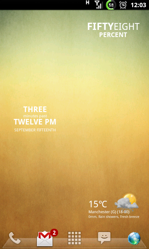

I'm *really* pleased with the result. Combined with Launcher Pro I've a whole new feel to my phone...
