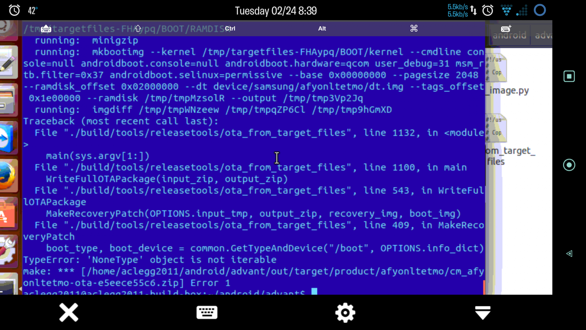

Oh yea'. Mostly just missing files. I did a search and put the files in the directory where they needed to go.Did you get any new errors?
I should have wrote down everything I have to fix. You got hangouts? We can start an advant room and if you need help building I can tell you what I did.Did you get any new errors?

Is everything synced to the github then? If so, I might just have to grab the cm11 sources and see what I can do myselfIm currently stuck at the recovery building stage on the rom building. Ive been stuck their since Monday.If I cant get it to work tonight, I'll take a break and think about a different way of attacking this. I need to get my build out to my g3 users, but I'm not giving up on you guys. Im pretty sure everything I've shared with j03lpr86 is what I pretty much have on my system.
Im not sure if he has or not. I think I got the recovery to work. I'll let you guys know if I get it to work or not in a few.Is everything synced to the github then? If so, I might just have to grab the cm11 sources and see what I can do myself
