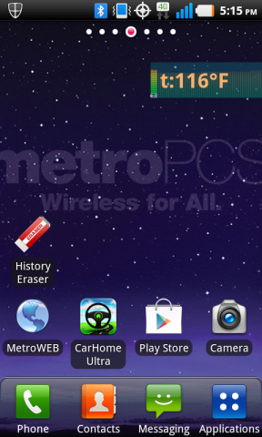

It will greatly help me if you can send in your temperature screen shots. The fastest way to get the phone to heat up is playing a 3d game, then letting it run on battery for like 1/2 hour. I'm interested in shots >40C/104F so when I talk to them I can show them proof that it's a problem for more than just myself.
If you have dead space, set your phone to display shut off @ 30 mins, start the game, get killed by a few monsters (like 2 or 3), leave it at the red screen that says retry/continue. I used 'cool tool' to show the temp like my screenshot. Do this on battery as using it plugged in makes it run cooler because the battery isn't doing all the work. I used screenshot ER to take the screenshot.
I got 107 F with normal scrolling through settings, ( i don't play the games).116 F on internet. I have juice defender, Removed 16 bloat app's and froze 14 apps. I just installed cool tool today to see temp. I know the phone gets hotter when it's on charger.It don't stay charged very long at all....

How on earth is your temp so low? Just scrolling down this thread my temp is at 105.8

Buddie2, this is the new battery overheating in the screenshots you posted? In another thread you said the new battery doesn't get nearly as hot. Yet the screenshot you posted today says 116
It does not get as hot but it still runs hot. I compared with the esteem and esteem was a 98 and my connect was 105.8 and going. so to answer your ? Yes it does help to get a heavier battery and or new one sorry for the wrong post before
That's with the new while charging the pic with 116 while not out don't go over 105. Sorry for not classifying what battery i was usin.
