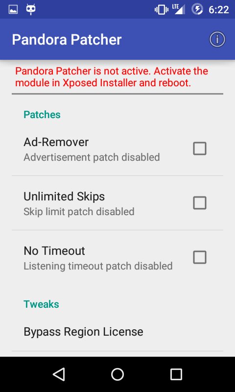

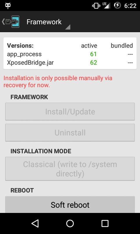

Is there a way to get xposed working on this I've installed it and it says its working but the apps I'm trying to use says that there not active but I did activate them and reboot my device
In xposed click modules then check the app and reboot
I'm getting that same error ....Some apps work. Greenify, tinted status bar work. Tried gravity box lollipop. No go.
