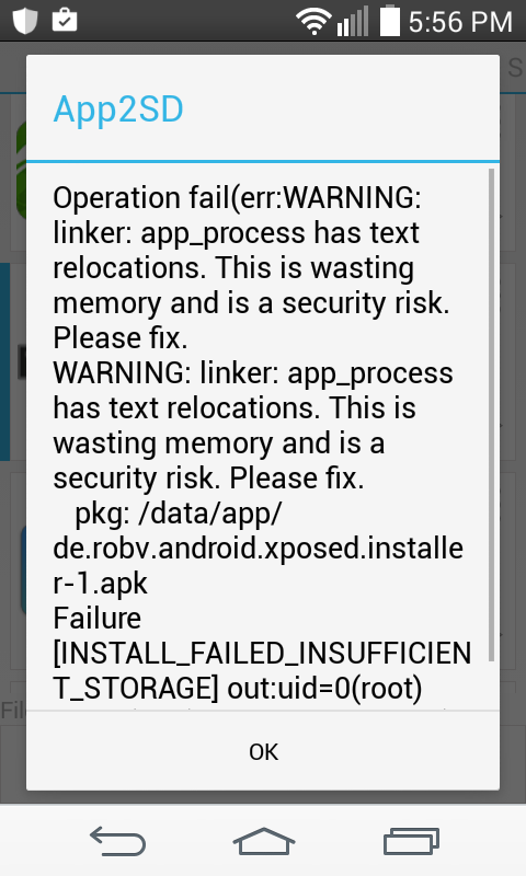

So is there a way to UN root my MS395 and start over? Rooted with TWRP but, since then I can't move apps to my ext SD Card. Get a warning/error message. Any idea's? Screenshot_2015-03-21-17-56-18.png
So is there a way to UN root my MS395 and start over? Rooted with TWRP but, since then I can't move apps to my ext SD Card. Get a warning/error message. Any idea's? View attachment 84328
App2sd doesn't work, your gonna have to repartition the SD card so that either link2sd or a similar app can link apps you've selected into the SD card.

Best answer I've gotten. I am a noob. I thought I did something wrong when rooting or flashing TWRP because I was able to move apps with Appmaster to the ext sd on a Galaxy Light, but I know it's not the same phone.. Anyway you are saying this it how it is with this phone and nothing to worry about.? Everything else works fine.

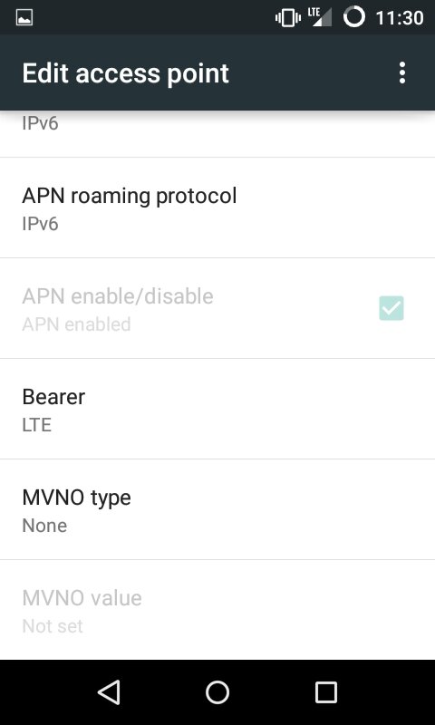

Still didn't worked. I've tried flashing the ROM just by itself afterward then select the correct APN, toggled the data (patiently...), still data doesn't work.
This is what I had to do to make it work just change the APN protocols to ipv6 and bearer to lte

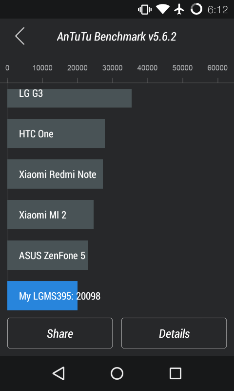

I love it. One issue I did notice its extremely fast but sometimes gets too ahead of itself and systemui crashes or device reboots. For example installing more than 10 applications all at once or just not closing app windows. Other than that smooth. Cellular works, data works fast lte and what's even better is my old stock os would disconnect me from cellular towers every hour and that would cause dropped calls but so far no dropped calls. 5 Stars! :)
