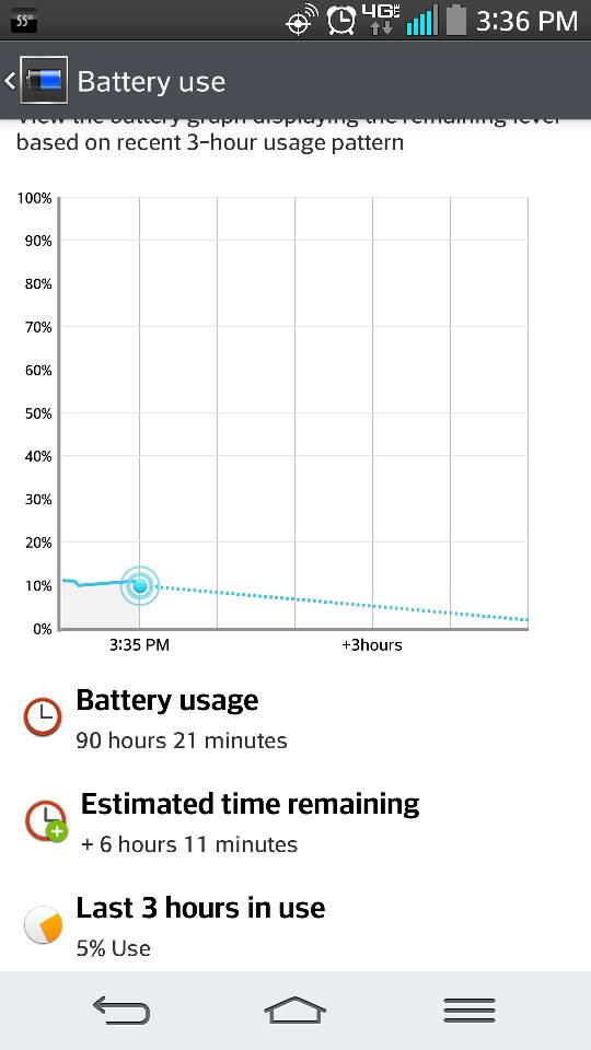

This is after update on vzw, with 7 1/2 hours on screen time
