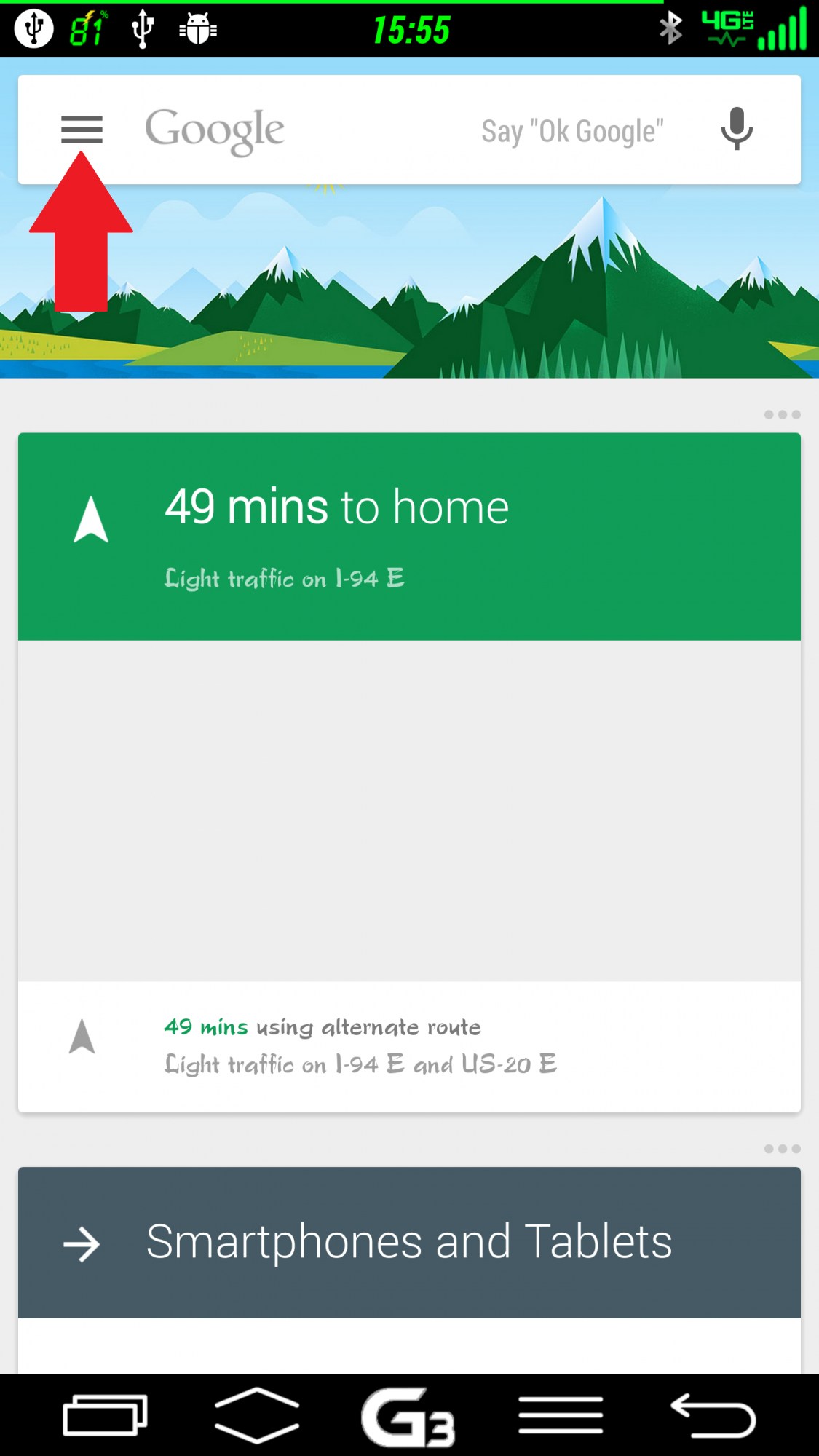

Could you give me some specifics on how to find the Google or Google now and then settings area on my phone? I'm having the same issue with speaker phone but don't understand how to get to where you and sherry are saying to fix the problem. Thanks so much!
Go into your Google Now app. (see pic) Open it up. Look for the "3-bar" icon at the left top..that will bring up a screent to go into settings:
then like @MurphysMagnet posted, Voice > "OK Google" detection > from any screen
