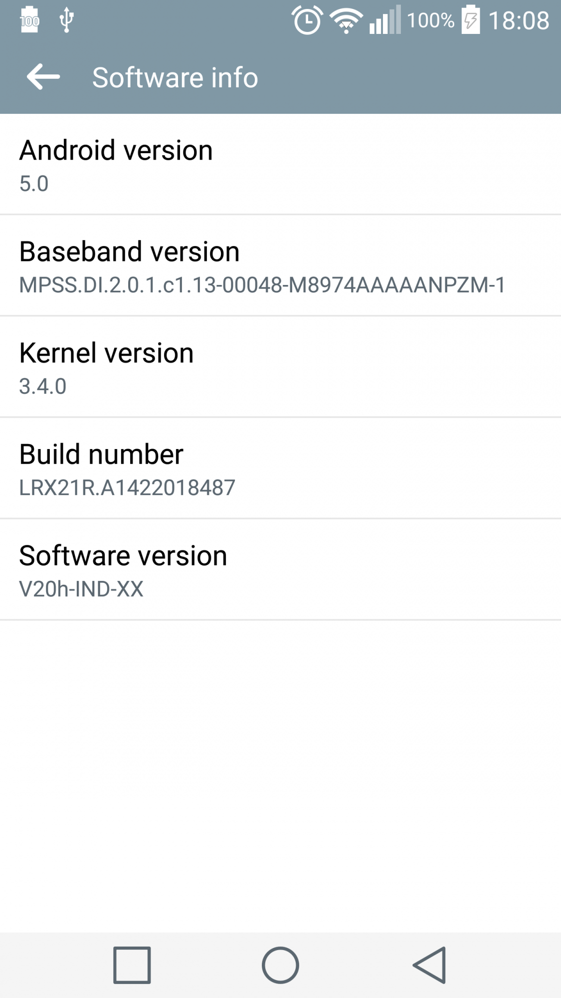

There are no such weird app or live wallpapers. Whatever 5-6 apps I have installed are from the android store. OS version is Lollipop and battery usage also seem to be normal. I checked with LG online FAQ and they say have to upgrade the firmware. I am not sure how to move forward from here.
I am from India and I carrier is Vodafone!
