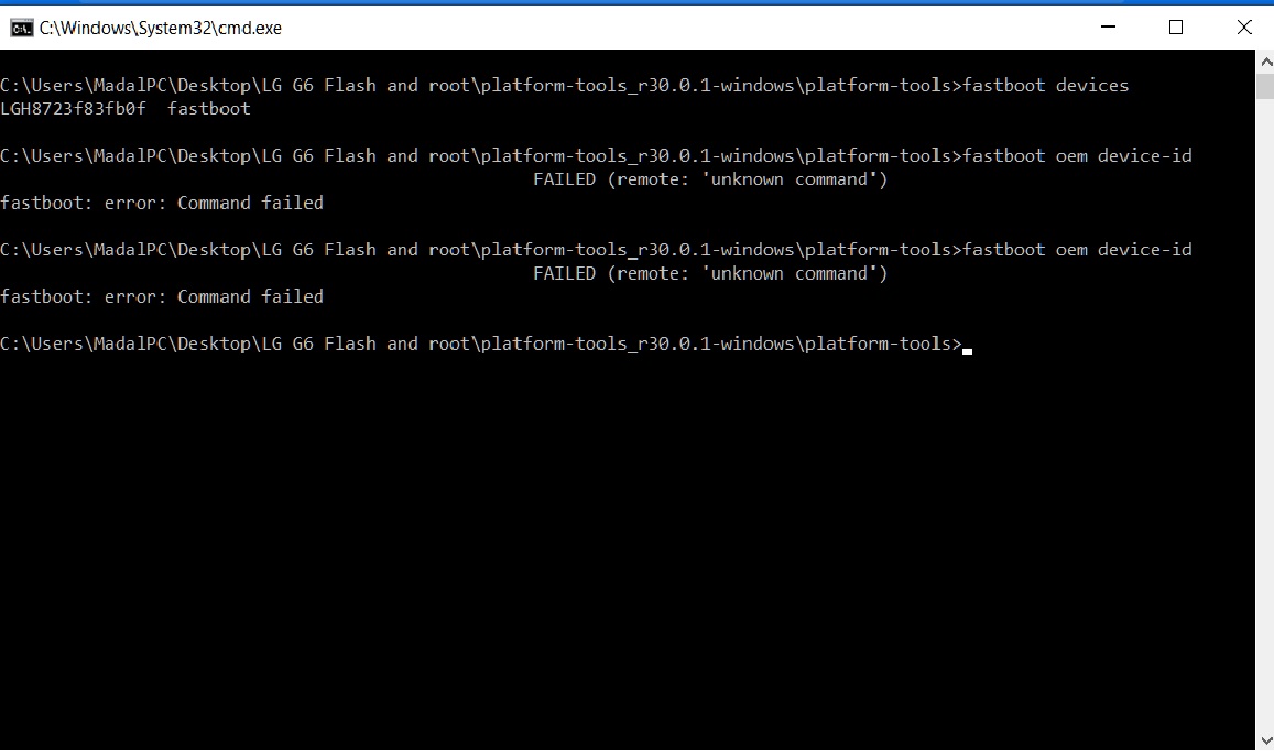

Hi,
I was trying to get the 'device id' to unlock the boot loader on LG G6 (h872g) with the fastboot command (fastboot oem device-id) however I keep on getting the "remote : unknown command" error.
"Fastboot devices" works and it shows my device being on a fastboot mode however non of the other fastboot commands works. I tried everything I possibly could including factory reset but i keep on getting the same error.

Hi,
i have uploaded the screenshot.
And yes the OEM unlocking in the developer setting has been enabled as well.
I tried multiple times restoring to the factory settings as well but its the same thing - kinda frustrating because it should generally work i thought.

are typing in
Code:
adb reboot bootloader
before you get the device id?
the phone needs to be in fastboot mode for the command
Code:
to work.
Yah the device is in fastboot boot and i came to fastboot mode from that adb command.
It also shows the device with ADB DEVICES command.
Is there another way to find the device id ?
that's the only way that i found to get the id. just curious what model of the g6 do you have?
Yah it is H872g which is the T- Mobile version. Unless i can install different version and then those fastboot command works???

Unlocking the bootloader is the easy part. You just type 'fastboot oem unlock' and that's it. The complicated part is flashing a custom recovery because apparently the version of fastboot that comes on the T-Mobile G6 doesn't support the 'fastboot flash ______ _______' command. Installing a custom recovery involves flashing the laf partition (download mode) from the h918 then booting fwul Linux from a USB stick and running a script that flashes your recovery to the laf partition, which finally allows you to root, flash roms, and install your custom recovery to the recovery partition. I got as far as unlocking the bootloader and flashing the laf partition from the h918 but the second step that requires using fwul Linux to install the recovery didn't work, for reasons which I don't yet understand. The phone still works fine but for the time being I've lost the ability to use download mode to flash a stock kdz firmware.
