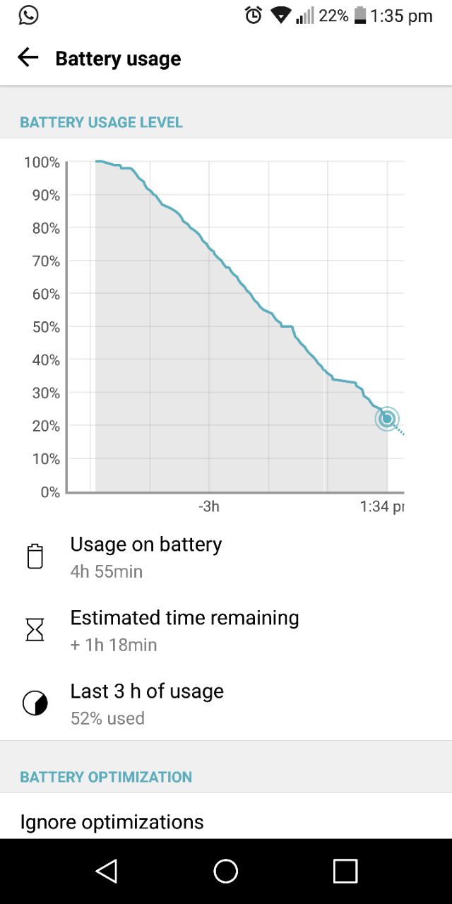

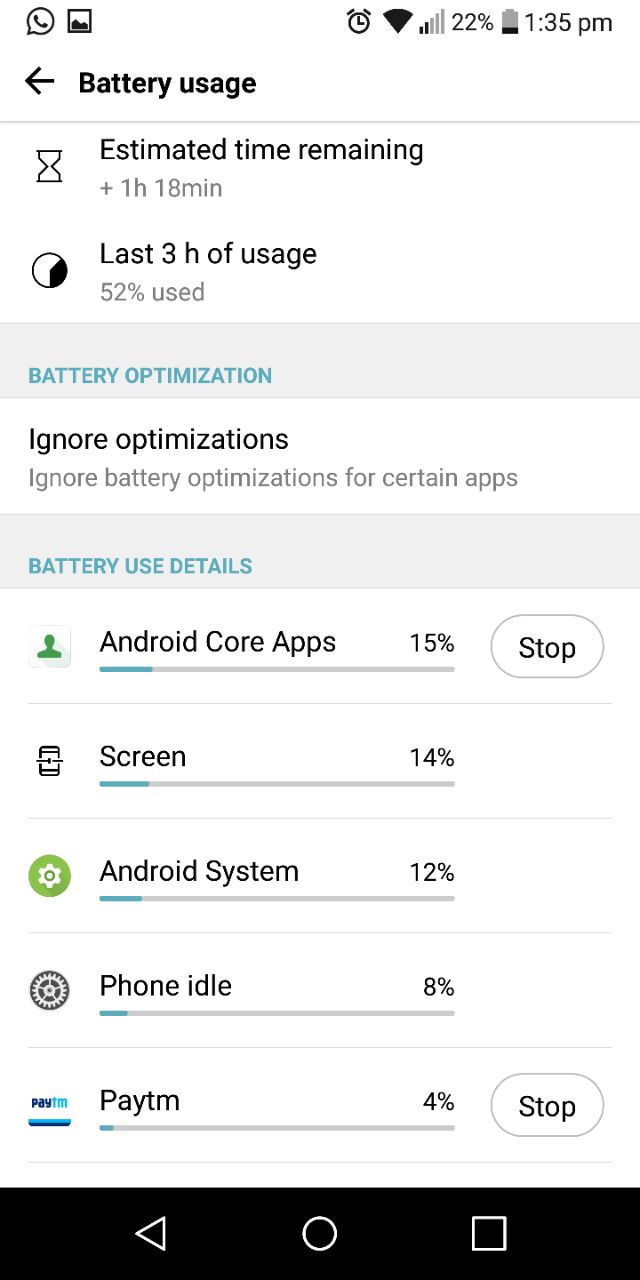

Got the OTA update on Feb 10th too - 1st Jan 2018 security patch / Kernel 3.18.31 - (India) - and the problems started immediately after.
SYMPTOMS
- Battery (used to give 6-7 hr SOT) now lasts for barely 2-3hr SOT. See attached screenshots.
- Phone is constantly hot
- Biggest battery drain is "Android Core Apps" (note that Contacts is part of this)
- Phone is laggy
- Dialer takes 3-5 seconds to call a number after i hit the dial button (eg. on recent calls list)
- Opening Contacts takes ~10 seconds before the list starts to populate
- Scrolling down on the whatsapp list takes 5-8 seconds before contact pictures show up (used to be <1 sec)
- People who call me claim it took me forever to pick up, but I picked up on the first ring
- Developer tools > Show CPU usage > On average its ~15.00-21.00 when the phone is idle. Lowest i've ever seen is 9.00
