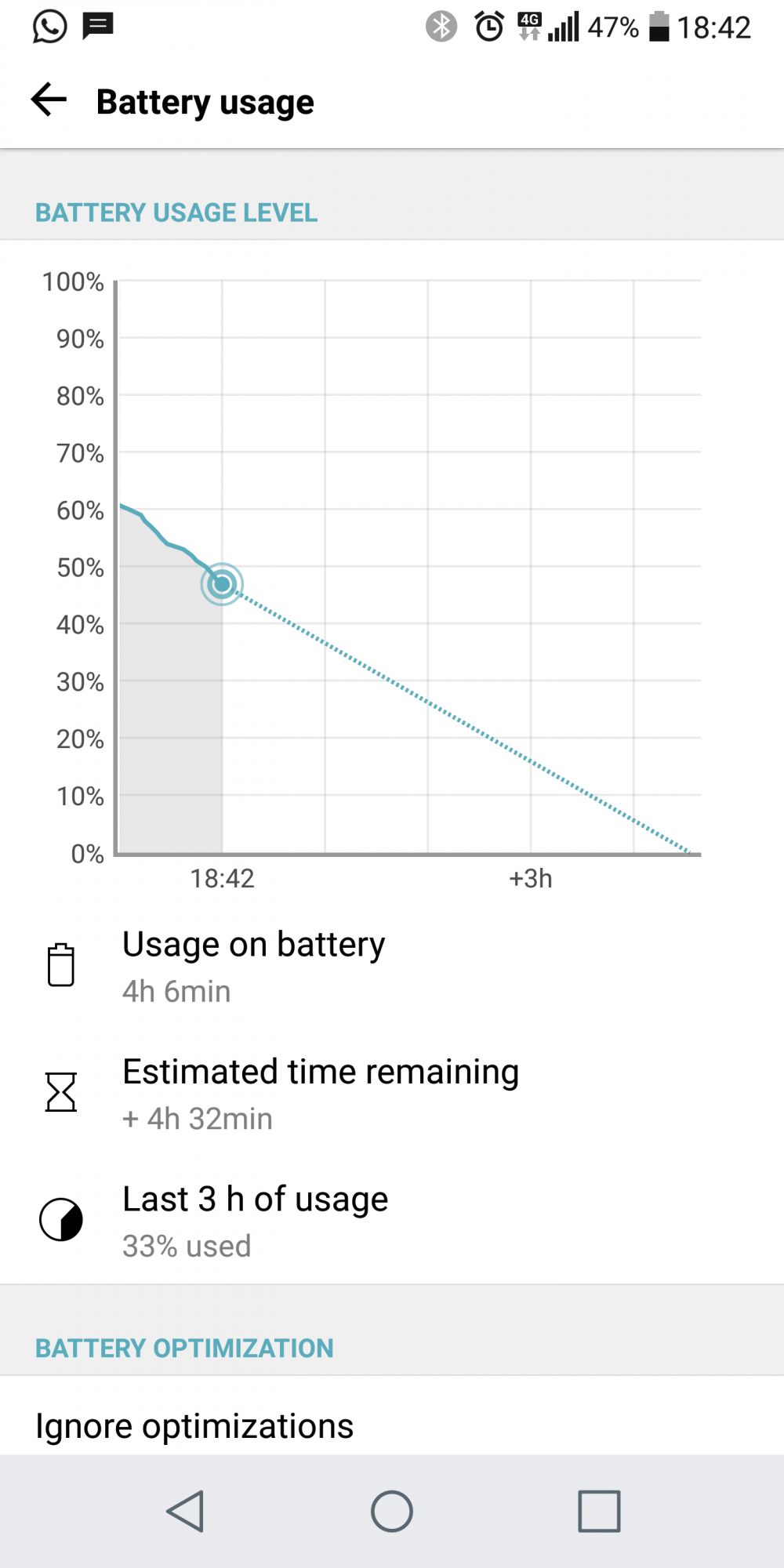

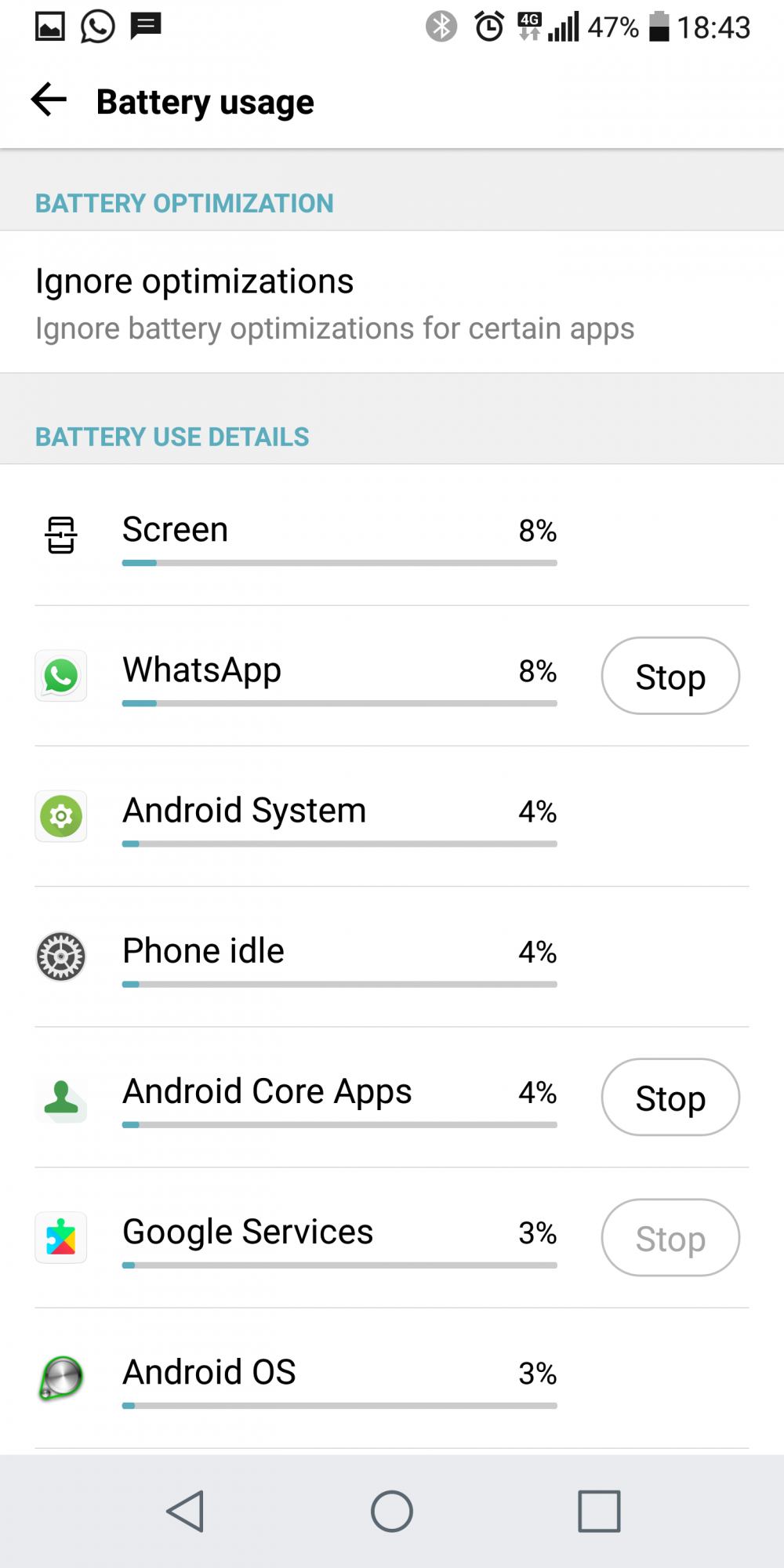

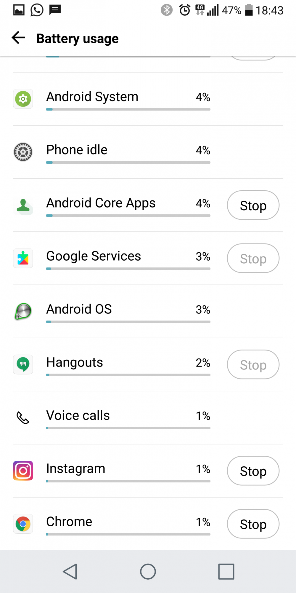

Could everyone experiencing this issue please go to settings>battery & power>battery usage and let me know what your biggest power using app or process is?

for those asking re battery usage
this is what i have, phone been on for about 5 hours (with hardly any usage): on 53%
phone idle 6%
Screen 6%
android core apps 5%
android syatem 5%
android OS 5%
whatsapp 4%
truecaller 2%
email 2%
facebook 2%
google play services 2%
voice calls 1%
yahoo mail 1%
I see Whatsapp in your list. That seems to be a common denominator with people experiencing this issue. Would anyone be willing to uninstall it for a week to see if it clears up?

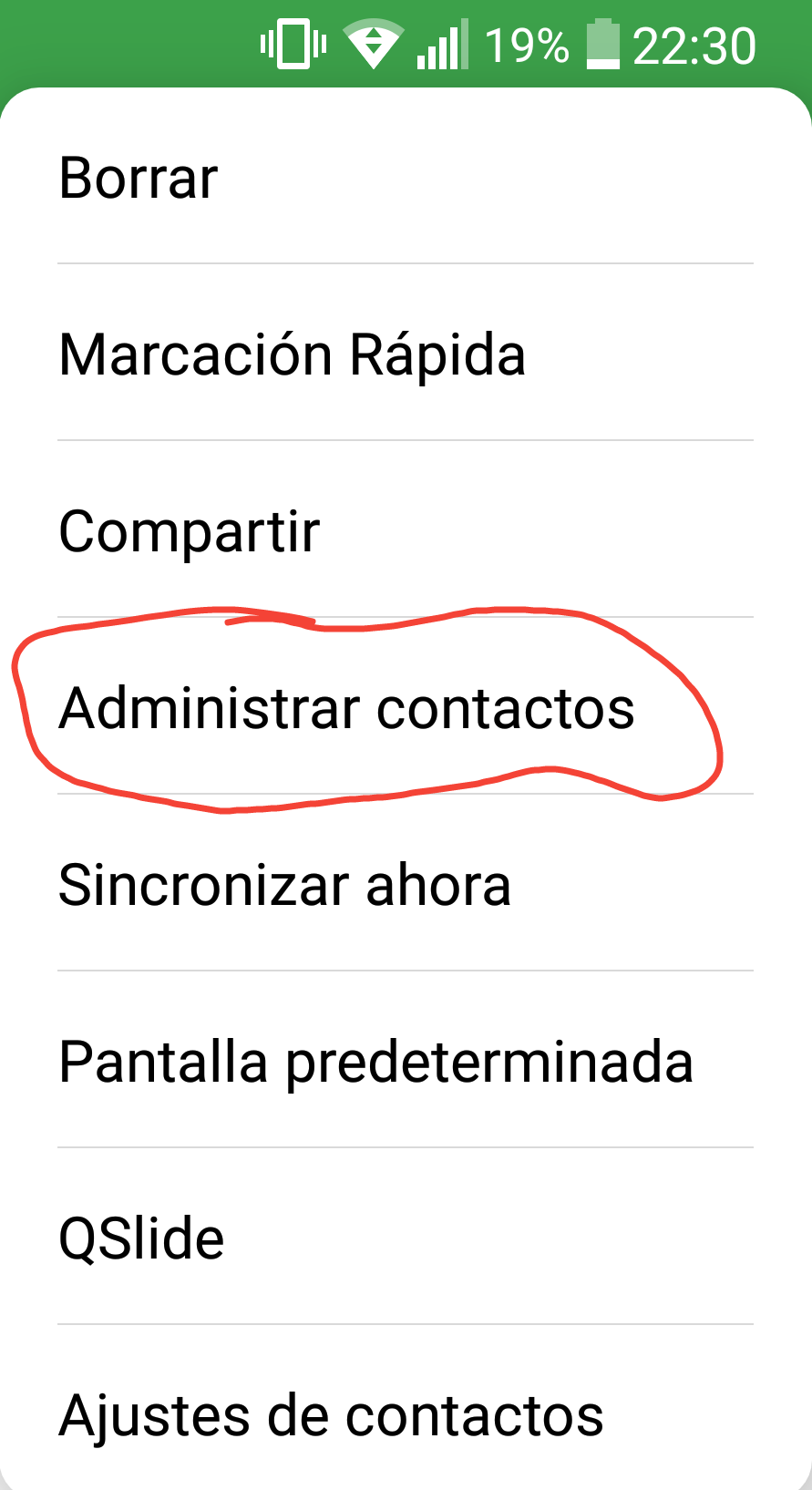

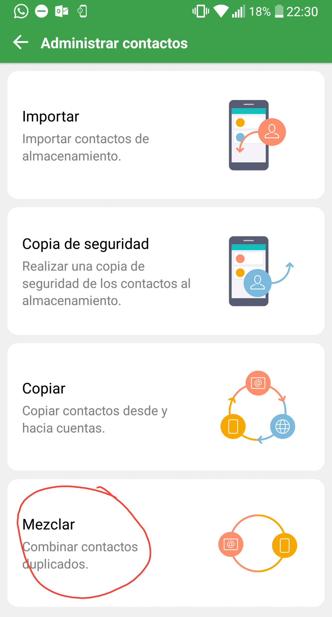

I think I have solved all the problems!!!!
I had the same issues, battery drain (android core apps was the third source of battery drain) and contacts app opened very slow (it took over 10 seconds to show all my contacts).
I clear up cache, stop sync with other google accounts, stop using nova launcher... but nothing seems to work.
And finally, I take the following steps:
1. Open "contacts"
2. "Administrar contactos"
3. "Mezclar"
4. "Combinar todos"
I dont know the correct translation into english, so I attach some screenshots.
In my case, I have many problems between my contacts in Gmail and Whatsapp.
After doing that, contacts are working as usual and battery is working much more better.
Tell me if this solution is also working for you all!

So last nighy before I went to bed I did the suggested above
Contacts
Manage contacts
Merge
Merge all
It took a while so I went to sleep.
Woke up this morning and so far amazing
