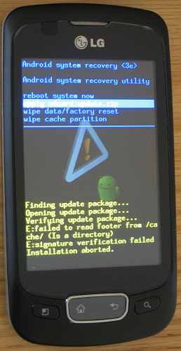

I've also seen these screens:
attachment.php
attachment.php
What do these mean?
